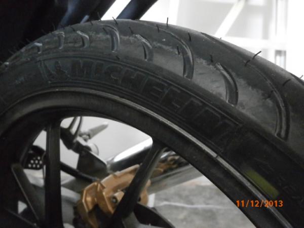

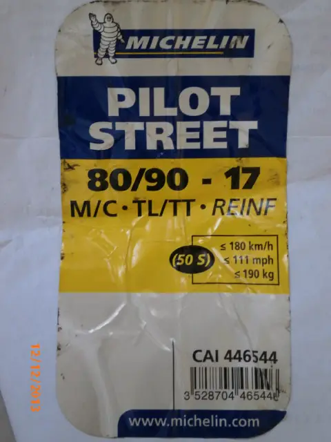

Michelin Pilot Street 80/90-17
meter 85633
11/12/13
RM95 setia indah fixed labour RM5 skudai

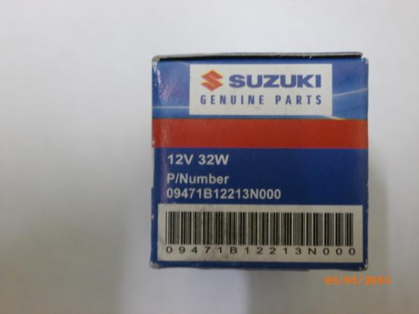

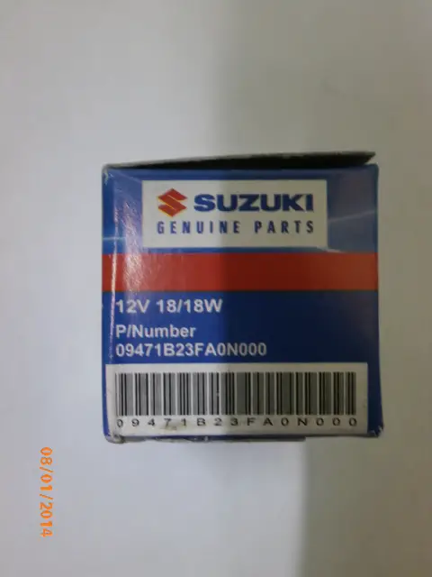

replaced rear brake switch and rear bulb
18 december 2013
take note - suzuki lights very sensitive
if bulb is getting dimmer and filament not strong we get
symptom
front brake lever when pressed , rear light never falsh/brighten
rear brake lever stepped , rear light never flash/brighten
after changing the rear bulb everything OK
also i changed rear brake switch just in case cause mine slightly not nice
RM 9.50

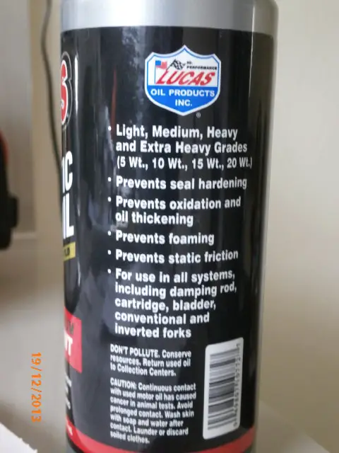

just bought LUCAS synthetic fork oil
courier service from KL to JB
10W medium weight
http://www.lucasoil-my.com/p_motorcycle_oil.html

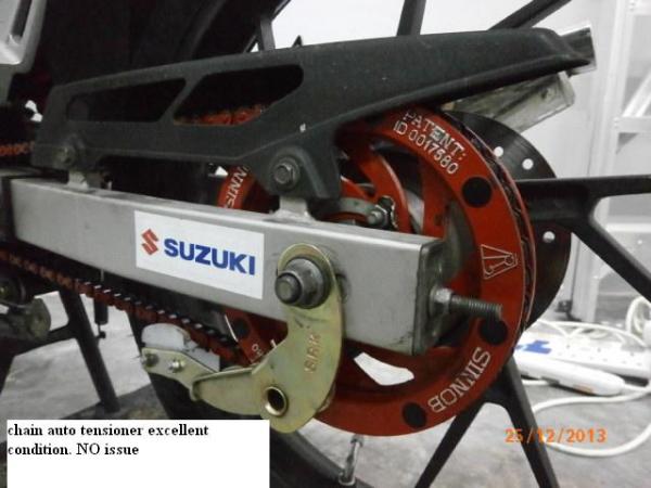

25 dec 13
skudai
meter 86475

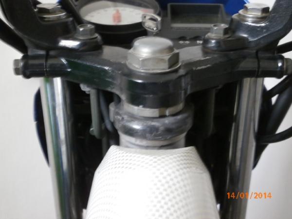

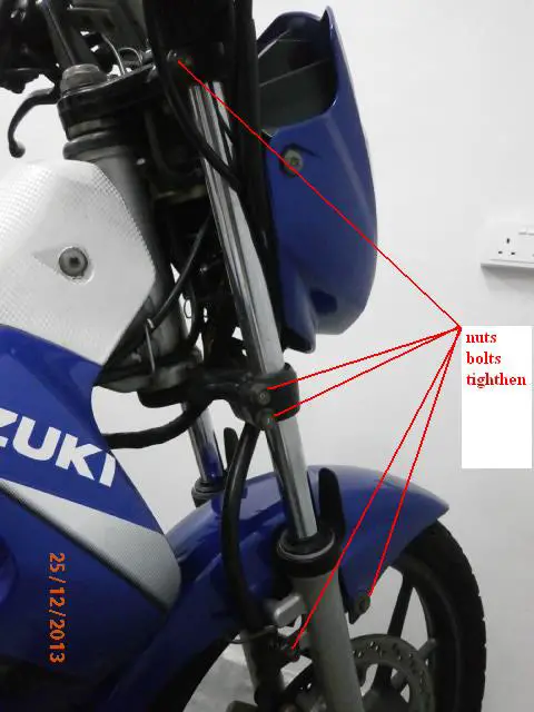

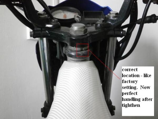

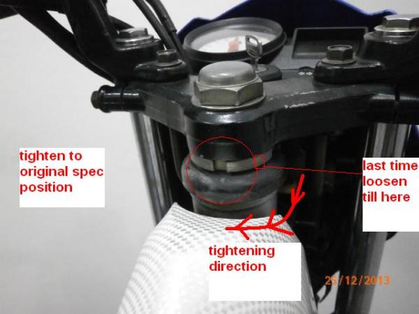

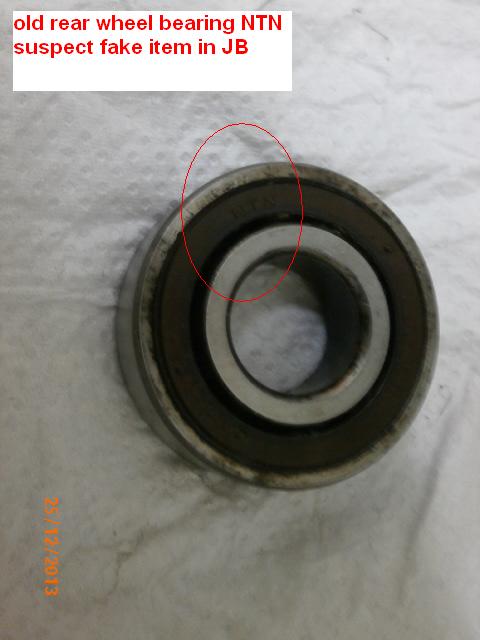

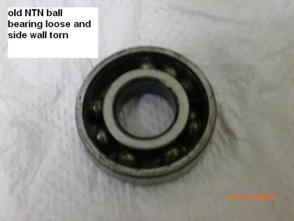

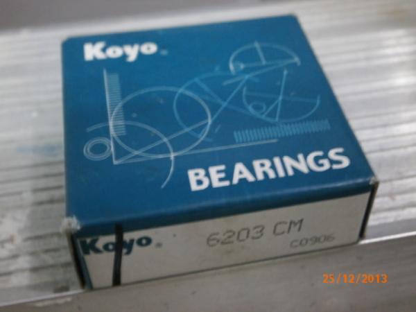

1. symptom rear wheel and chain drive noisy but rear wheel never wobble or shaking. So alligned the chain drive and front sprocket but still noisy. Removed wheel and checked the bearing. Confirmed ball bearing loosen and side wall torn. But amazingly it never make wheel shake or wobble. Changed bearing to KOYO made in Japan both side covered type. Last time used NTN made in japan suspect NTN was imitation /fake item as largely can be found in JB. So used KOYO which is genuine imported. RM14
2. had tuck tuck noise from front wheel fork system. Tighten all nuts/bolts and adjusted to factory setting handle bar steering stem and tighthen to correct measurement.
Now all noises GONE

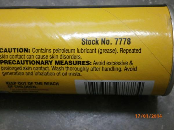

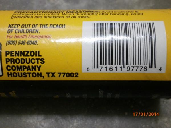

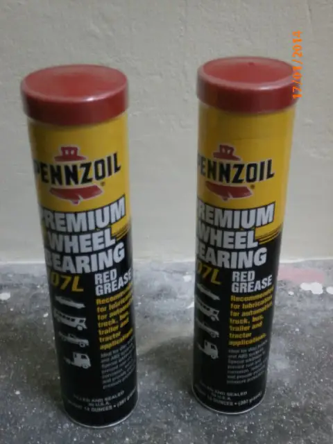

now for GREASE
many of us ignore greasing parts
bikes need greasing done 16,000km on chasis and some other areas
cvt scooters need greasing done 8,000km
i suggest buy one tube or one pack marine grease. Is the best grease and has highest of all criterias
read more on grease
http://www.etrailer.com/faq-grease.aspx
to test grease. Take a spoon of grease and put naked fire via lighter. if it melts then this is fake grease. Good grease will not melt.
for msia we still can use penzoil
Pennzoil® Premium Wheel Bearing 707L Red GreaseA premium high-performance grease providing excellent high-temperature protection and resistance to water washout, and with extreme-pressure properties. Pennzoil® Premium Wheel Bearing 707L Red Grease is formulated with a high dropping point, is an excellent lubricant for vehicles with disc brake and ABS systems, and is ideal for chassis lubrication. Premium red color

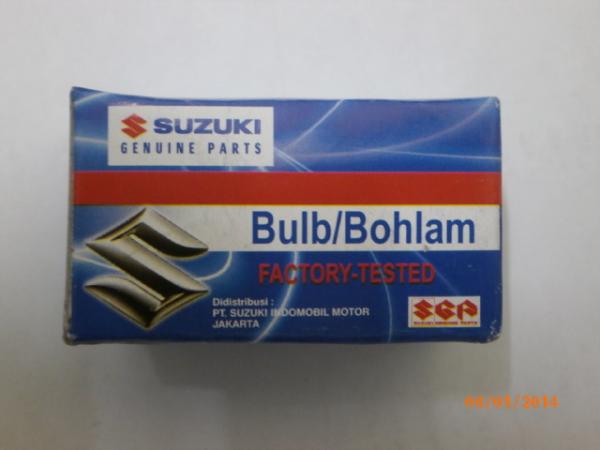

i just bought bulb bolham stanley
oiginal suzuki 32W and 18W for raider R
for spare and future use in case bulb get dark

I bought this it is GC-LB highest spec and best in grease for wheel bearing, chasis and disc brakes
Pennzoil 707L premium red grease
SGD 12 Rangoon rd
now for GREASE
read more on grease

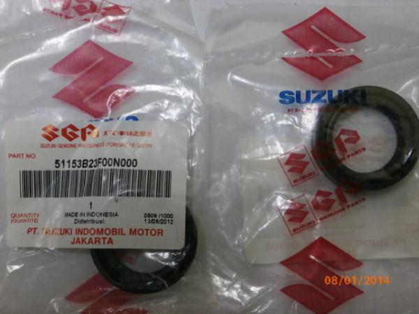

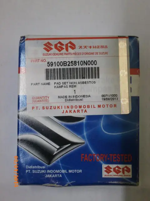

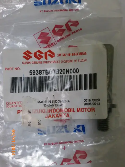

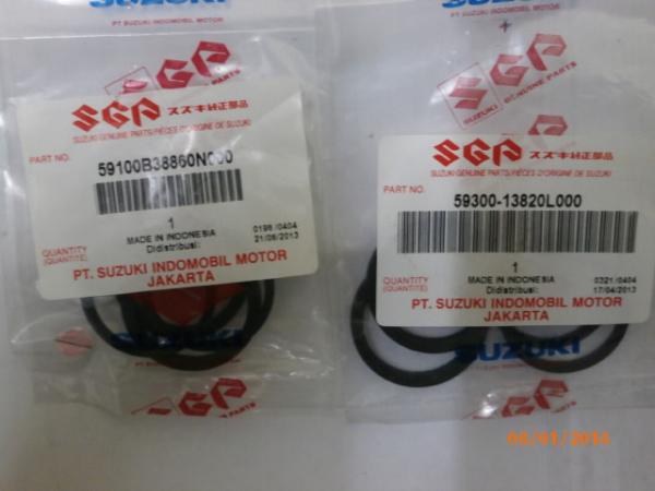

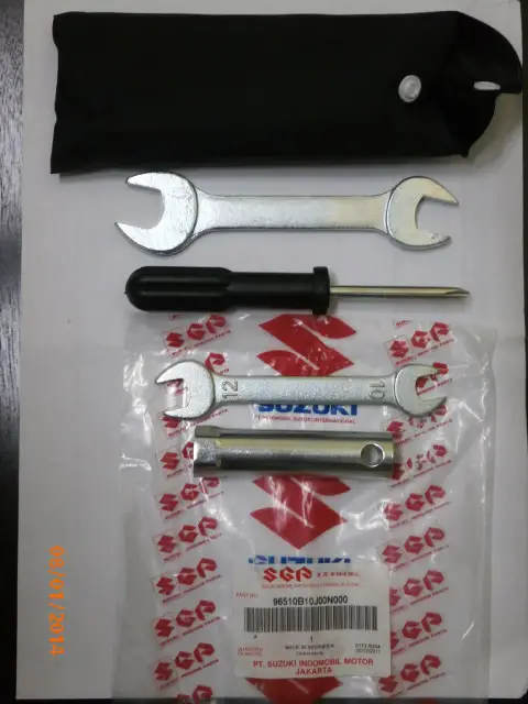

went shopping bought some spare parts
also
ordered and bought some spare parts
for future use long run purpose
see pictures
also
see pictures

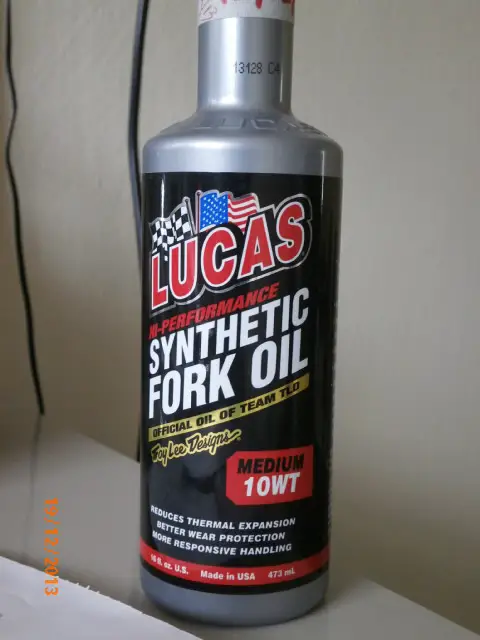

take note guys
fork oils have 4 years shelf life span
so better mark your bottle
also take note of factory packaging date
like mine was - The product have a code date.. and yes they have a shelf life of about 4 years.. Looking at this code, this one was made in May 8 of 2013..

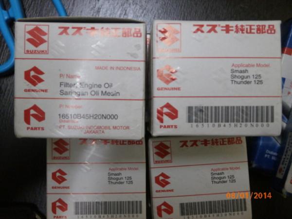

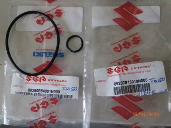

88153km
14/2/14
skudai, JB
changed 2 disc brake brake fluid DOT 4 Mobil
service front disc caliper and put pennzoil red grease 707L
ngk G-Power
air filter
oil filter with two O-ring
shell r4 engine oil
fork oil LUCAS synthetic 10W
total service RM26

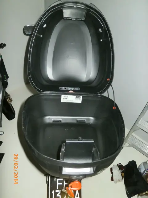

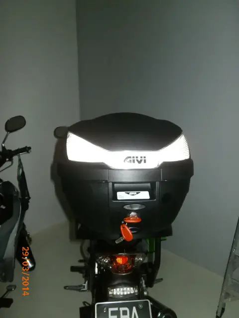

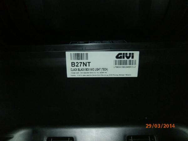

skudai JB
28 March 2014
RM130 box price only including fixing
Givi B27NT Clack
aerodynamic
white reflector
monolock
27 liter
stability at high wind
stronger material
made in italy
Edited by gunshead

Skudai, JB
Suzuki Raider R
28 March 2014
90064km
Givi B27NT Clack box RM130
service
engine oil R4 Shell
Clean front sprocket gear sensor area
Grease 707 pennzoil front wheel to smooth
spacer axle and seals
checked
bearing handle - ok good
clutch plate - ok good
Labour RM5
