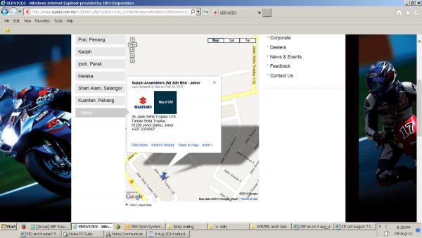

Thanks for the feedback. Maybe this Saturday will drop by to JB for the changing. Is it true that Setia Tropika shut on Saturday?
setia tropika
Suzuki genuine service centre
Monday to Friday
8am till 5:15pm

try one time take annual leave and go to setia tropika
before go
u must call and make appointment

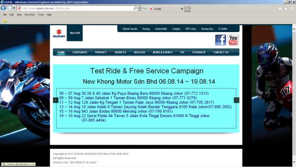

always check the website http://www.suzuki.com.my
they host free test ride bikes and free service campaign
u will meet those technicians directly from factory penang over there
see attached
