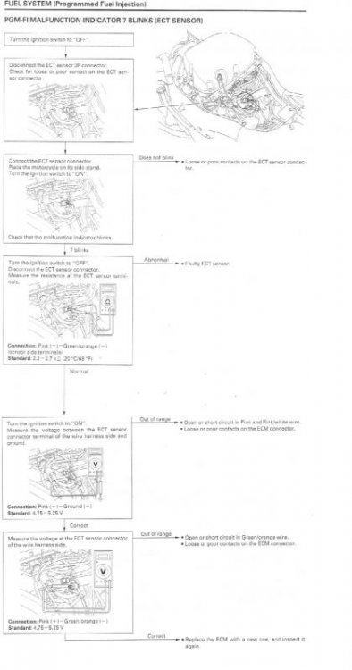

My bike got over heat again FI blick 7 time ETC problem.
When back to shop change new ECT sensor temp change to 132 dregree than temp never come down.
Dont know whats wrong.
U got ask the shop to check ur cooling system?

Yesterday FI blink 7 time change the ECT sensor still FI light comes out. This time funny the temp remains at 132 deg nvr come down. Shop already change the new whole set harness wire from honda but still the same any old bird bro encounter this problem before. Seems like the shop DE XING dont know what they are doing. HELP!!!!
Temp hit 80 deg FI light turn on. Also change the aluminum thing (im not sure wat is it) it where the coolant pass through . After replace that thing it also same.
Edited by sanasakai

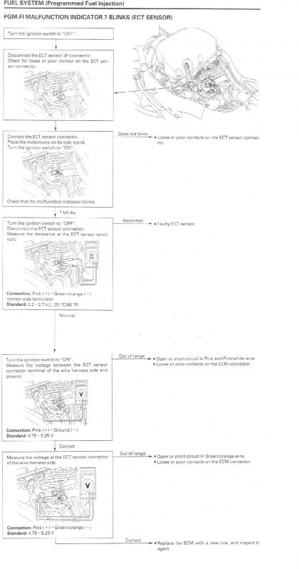

Maybe u wanna try doing this from the manual:

So u've change harness and thermostat...i suggest u bring the bike to Alai.He's more well versed in blackbird.

One thing about bb's electrical is straight forward..check sensor..check wire...if cannot last step change ecm (thats if its just electrical problem and not mechanical...)..

Is it the infamous 25blinks? Because that gives a 7 blinks (Total) as well.

Ya can be also bro..if the mechanic dunno how to read the error code..7 blinks will be 7 continuous short blink..25 blinks will be 2 long and 5 short blinks...

ya can be also bro..if the mechanic dunno how to read the error code..7 blinks will be 7 continuous short blink..25 blinks will be 2 long and 5 short blinks...
ya bro i got this type of blink. What is the problem. Pls tell me.
2 LONG 5 SHORT
2 LONG 5 SHORT
2 long n 5 short is 25 blinks..this refers to knock sensor abnormality..the service manual indicates to replace the knock sensor..if error code still flashes the its either wire harness or ecm.
To check harness you simply need to find the wire from the knock sensor to the ecm( not sure about the colour you need to check the wiring schematics) for continuity (by using a multimeter). If continuity is ok..then its highly ecm..most blackbird before 04(if i'm not wrong)have ecm problem unless a newer updated ecm is installed.
Basically when the bike have 25 blinks,its still rideable..bro bluejelly's bike have this problem n he still happily ride the bike up north..only thing is the iritating blinks flashing, the bike will not work 100% full potential power and eat up abit more petrol..
