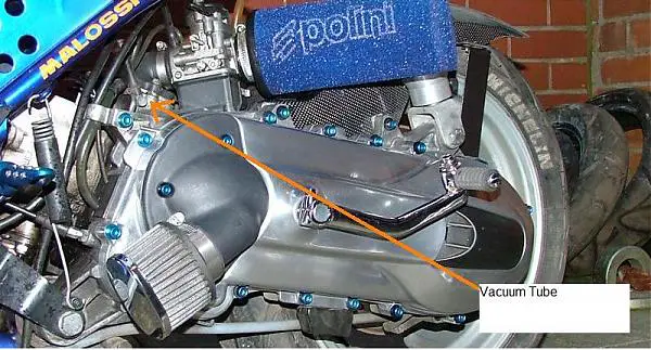

one of the hose below carb always come out when i start the bike n make sound like air flowing n bike direct of when i put it back it can start n work as normal the hos is not connect to carb but it connect to something below carb if not wrong it call intake ......
got any experience on this ......
your English is rather hard to understand...perhaps u should attached a picture on what u are trying to say.
Anyway from what I can understand, it should be the vacuum tube that had drop out...(Look at my attached picture on the tube I am talking about)..
If it is really that tube that drop out, then go n glue it back or use a cable tie to secure it at the moment..common issue that will always happen

heheheh sorry about that ..
it not only the hose but it together with pipe where connect to the hose so can use glue to stick it back rite??
yes...if still can ride, secure wif a cable tie n then go to bike shop they will glue it back for u properly
Whahaha.. i encountered this before on my runner as well. :cheeky: What the bike shop did was to use a metal piece to hold that thing in place. Alternatively, i think can also try those silicon thingy and paste it back. But you would need to let it cure for about 24hrs before u can ride the bike as per normal. I would choose the metal piece thingy as its easier to do and its faster though not as nice as the silicon option :lol:
