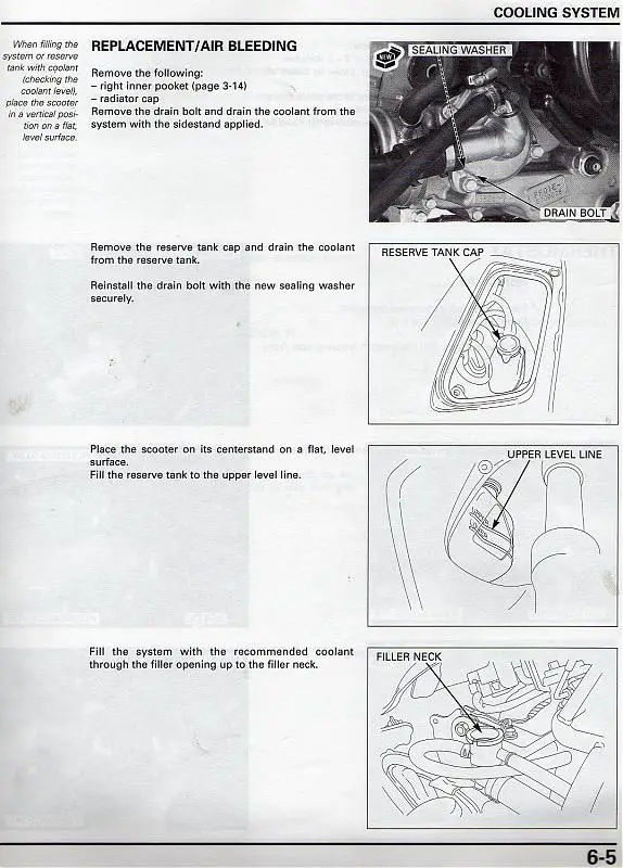

does anyone know where is the coolant drain plug?
feel like flushing my coolant when i'm free.

but i that is where to top up the coolant right.
i need to find the drain nut.:angel: :angel:

Drain on side stand. Think page below is all info u need for coolant repacement.
things to take note:
1. Do not remove the radiator cap before all coolant is drained. This is because the pressure inside will suck out the coolant from the reserve tank too. If u remove the radiator cap half way thru, u wont be able to drained all the coolant in the reserve tank.
2. remember to remove the RESERVE tank cap during draining. This will improve the draining flow rate.
:goodluck:
:goodluck:
One more BIG tip for your DIY radiator fluid replacement - Use only PURE WATER (from pharmacy) not tap water or other dubious sources where some chemicals are added or those so-called commercial mineral waters in plastic bottles. Mix the PURE WATER in a clean bucket - exactly 50% with a good coolant (i use the Honda or Fiat coolant) and top up from the Radiator cap filler when the Engine is COLD. This exercise helps to minimise corrosion and deterioration to the metals / plastics / rubber in your cooling system.
wow, i nvr go till this extend man ! cos straight after draining i pour in pre-mix coolant already..
