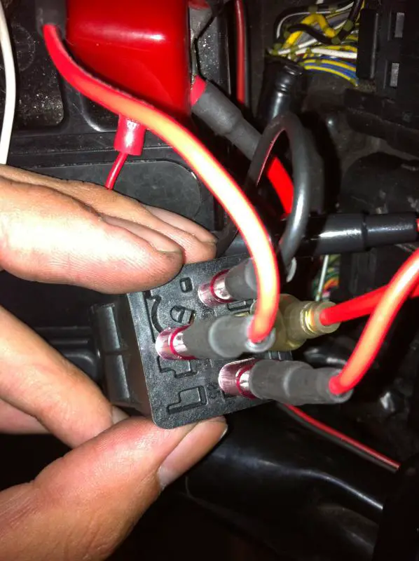

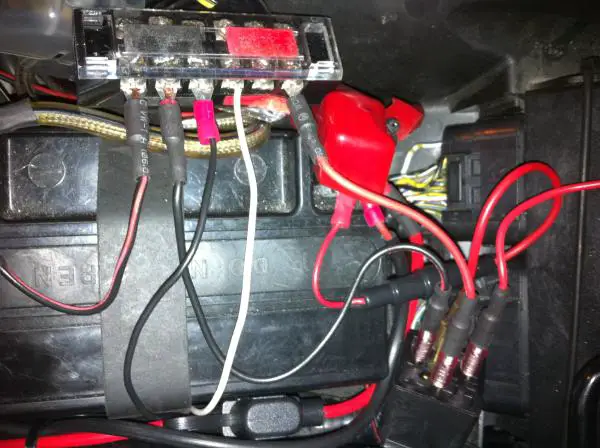

From what I can deduce, having followed limbatt's "recommended battery charger" thread, it seems like he has a couple of charger units. Those are the premium ones which have a "recondition" function which is capable of nursing back some dying batteries. Not all can be recoverd though, but it's worth going down. Look look, see see, shop for second hand charger.
Haha, if you regularly leave it for long periods, gonna have to charge it sooner or later! Maybe fashion a Power Distribution Box. Tap all your accessories and main harness to a distribution box. Then, your battery only needs to be hooked up to the distribution box. Install quick-connect to the PDB and one click, off comes the battery.
http://i884.photobucket.com/albums/ac46/Tachnicolour/Completed%20works/combination_2.jpg
Convert your backlight COLOURs at : <CMO> Speedo Backlight colour CONVERSION by Tachnicolour
Hmm, something like this? Attached is my 1st version of the block.
Anyway, for a battery, that's more than 2 years old. It makes good sense to change to a fresh one (Prime it yourself for it to be as fresh as possible!)
As mentioned, it's good to have a battery conditioner since you don't really ride often?
[ATTACH=CONFIG]232685[/ATTACH]
[ATTACH=CONFIG]232686[/ATTACH]
