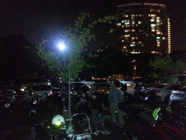

Mass NC700 meetup, hopefully can get to see Integra on è next outing.

nice....where is that location you guys took the pic at?

the meet up was at ecp carls jr carpark and photo was taken at one of the heavy veh carpark along the service road.
