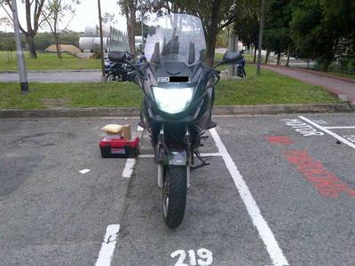

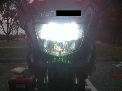

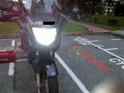

If any of u guys r interested in convertin ur headlites to hid can consider engagin my installer. Very neat n gd wkmanship wif reasonable price. He does installation of headlight switch too.

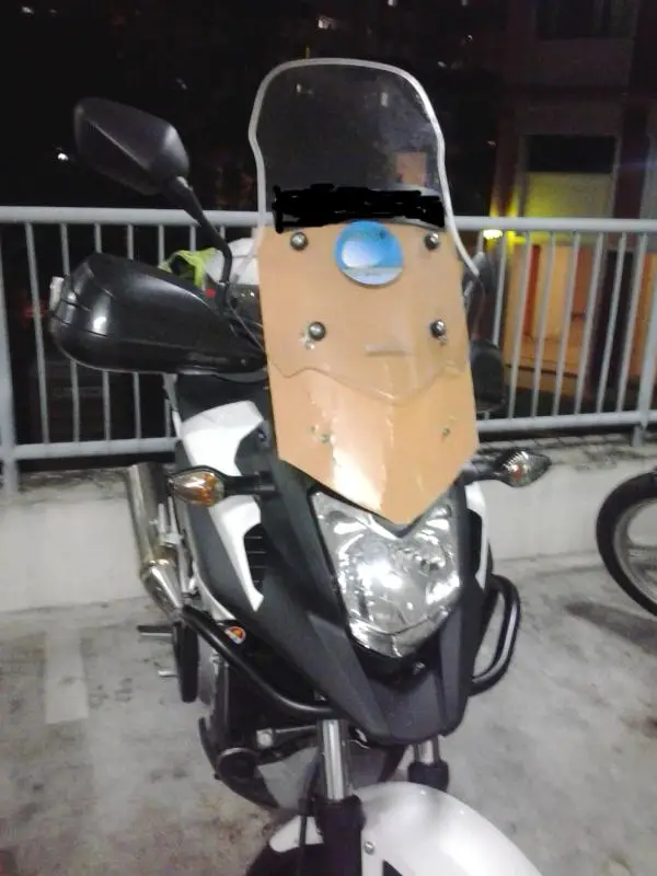

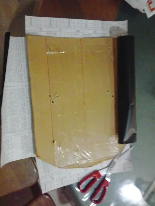

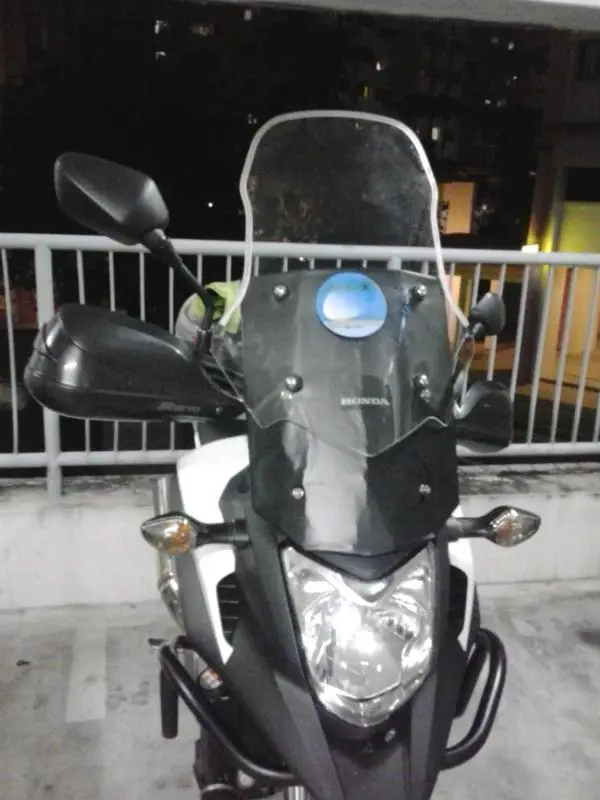

I added a DIY extension to the Honda tall screen so as to raise the height. Now the high pitch wind noise has disappeared almost entirely. the wind is not directed to my face now...instead it is flowing thru the top of my helmet... just nice.
Here are some pictures [ATTACH=CONFIG]262525[/ATTACHA2012-11-15 21.51.10.jpg 2012-11-15 22.14.18.jpg
Note that this is a temporary measure...i used some woodboard i have at home and wrap it with vinly sticker for waterproofing.
Intending to try touring first and see the results more.

bro from ur pic see that u join the wind-shield at the bottom, why not getting a taller wind-shield or a wind deflector instead.

1. This is a trial, i want test wind noise at different height if
necessary.
2 . I already invested in honda tall screen and i like the support bracket
and screen quality.
3 . Adding deflector at the top costs money and also dont know if it works well
and lastly worry kanna stolen easily. Just clip on.
4. Adding from bottom means i dont need to drill hole at top or find clear plastic
to add on for trial.
5. The only problem is the slight touching of cable when handle turns full left..but only slightly
in this case. No problem to lock handle nor ride.
6. I might consider a larger screen or make a better diy in time to come.
So far only the calsci screen looks big enough but i read some installation
and cracking problem thru online forums.
I think the current set up is already very good. Not sure if a wider screen will be better.
necessary.
and screen quality.
