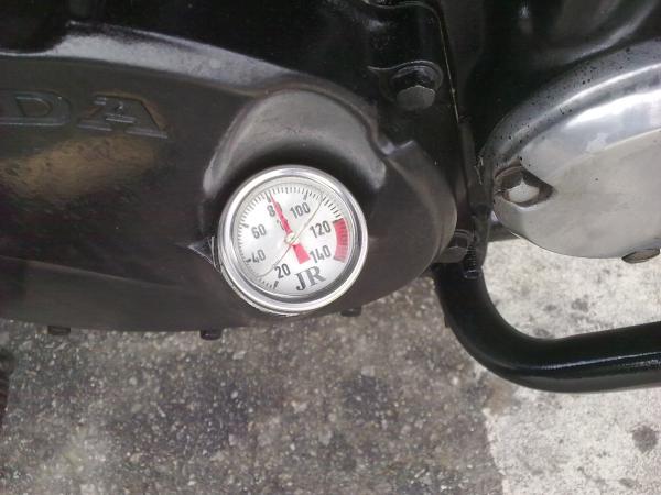

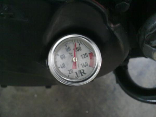

i have change to my fav Fully Syn motorcycle oil at noon today ... took time off from work to "change oil" :cheeky:
82 degree Celsius for normal riding (at noon)
94 degree Celsius for abusive riding (at noon)
well, honda cub can survive using used cooking oil too:
i trust my dip stick thermometer and will use oil that produce lesser heat :thumb:
