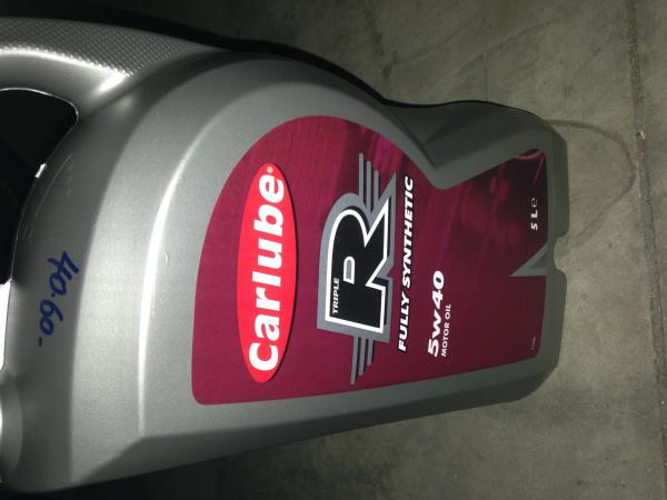

Anyone have tried Carlube fully synthetic 5w40?
Any feedback?
[ATTACH=CONFIG]284340[/ATTACH]
Exceed API SN
Retail at $8.80/1 litre or $40.60/5Litre

His engine felt sluggish and when drained, it was like water
Any feedback?
Exceed API SN
for bike, try to avoid anything that have such a wide viscosity spread like 5w40. it get chew up by the transmission in no time.
the common understanding is that Engine Oil(EO) is make by using a thin oil and viscosity index improver(VII) is added to thicken it up. hence the widen the spread, the thinner the base oil and the more VII have to be added. we all know too much VII is not a good thing for motorcycle oil as VII polymers usually get destroyed through the motorcycle transmission gear and the EO thin rapidly.
that is half the picture. EO is usually make up of at least 2 grades of base oils or more. some EO may have more then 10 grades of base oils in order to achieve it desired properties especially synthetic oil hence it is much more difficult to formula a good synthetic oil then a mineral based oil.
for example, a simple binary EO or a 2 base oils EO normally make use of the base oils to control it viscosity as well. normally there will be a thin and thick base oil mix. the thin oil serve to improve flow during low temperature and the thicken oil is used to prevent the EO from thinning too much at high temperature. so to control viscosity, VII is not the only factor come into play. the industry is moving forward to using base oils to control the properties of the EO. for example, i sure some of you have notice that motul flagship oil 300V is phrasing out for their new range of oil called "Ester Core" through the advertisement here. They are replacing traditional metal based additives with organic based solution like different types of ester oil to improve the oil properties but that another story.
some types of EO used thicker base oils and add pour point depressants to spread the viscosity range of an EO instead of using a thinning base oil and adding VII to it. there are quite a number of ways for the tribologist to design a multi-grade oil.

Currently using on my Spec3

it still great in a way for rider who do mainly short trip of less then 10mins where the EO will hardly raise to operation temperature or in some bikes that can get away with lower viscosity like Honda bikes from 2006 onwards which called for a 30wt oil.
for bikes that depend on viscosity to protect itself, that are alot of better choices out there.

Noted.. Thanks man..
Will change to maxima extra 10w-40 soon..
Currently about 500km on Carlube 5w-40
