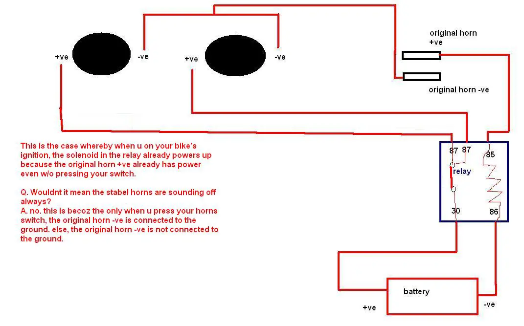

A point to take note. For some bikes, when the ignition is turned on, the +ve wire from the horn already has power (which activates the relay). when u press the horn button, it connects the ground and the stock horn sounds off.
so when using the relay, it is better to connect the -ve of the stabel horns to the orignal -ve wire from the bike. if u connect the -ve of the stabel horns directly to ground, your horns will sound off immediately when u turn on ur ignition.

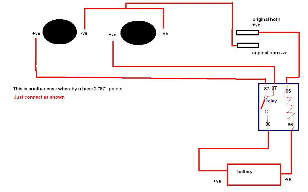

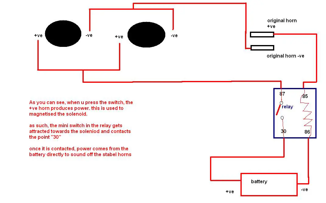

If u r using given a 4 pin relay in the package. (dun worry, 5 pin or 4 pin relay, both, by right shld be normally opened relays)
http://img257.imageshack.us/img257/8791/horn1xj1.jpg

when u r given a 5 pin relay instead of 4 pin relay
http://img257.imageshack.us/img257/6606/horn2le7.jpg

this is another case which is rare. whereby the +ve horn already has power when the bike's ignition is turned on
http://img148.imageshack.us/img148/4563/horn3xw6.jpg

Q. Why shld we use relay? y cant we directly replace the stock horns?
A. this is becoz your stock horn wirings might not be able to handle the larger current a stabel horn draws. by adding a relay, u can see that the stock horn wirings only takes a small current, that is to magnetised the solenoid in the relay.
the larger currents are taken care off by the additional wires u added.

http://www.unc.edu/~shu/horn.jpg
Hope I could get some kind's soul help here.
I tried to DIY this horn circuit and I think i screwed it up big time and need some help.
Here's the things I do not understand about this diagram.
1. For the 2 (-)negative points on the horn, do i just connect it back to the black wire from the original horn and leave it as it is?
2. I have 5 pins like what is shown in the diagram. Am i supposed to separate each (+) positive point from the horn to 87 and 87A respectively? eg. left positive go to 87 right positive go to 87a?
3. I have to link a wire from 30 all the way to the battery with a fuse between it? Did i get this right?
4. Can i use the red wire , connected to the fuse, from the original horn to connect to 30? Is this wrong?
5. Is no. 4 is wrong, how should i rectify it?
6. I'm not sure whether did i get this right, right now i'm thinking, Am i supposed to connect the original horn's red colour wire to 85 and black colour to 86 as according to Neo's photos?
7. Lastly, I do have a black white and black blue wire at the horn switch. I'm not sure whether am I supposed to cut those to fit it at 85 for the black white and 86 for the black blue. If i do that. what about the red and black original horns wire?
i've temporary solved the problem by using the original relay and doing a parallel connection for the 2 +ve points of the horns.
Here's my current connection.
2 horns +ve connected to 87
2 horns -ve grounded to a nut.
1 +ve wire with fuse connected from battery to 30.
original horn +ve connected to 85
original horn -ve connected to 86.
I have new questions.
1. If i want to use the relay that has 87 and 87a, i have to connect the 2 horns -ve to the original horn's -ve?
Then I'll have to link a wire from the battery's -ve to 86 in order to use it that way as shown by the circuit image below? courtesy of paiseh
When i connect the relay with 5 pins with my current set up as similar to nEo's pictures, one of the horns will go off even without the ignition on.
