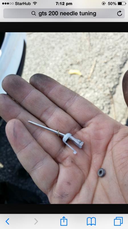

Hahahah that is my photo bro... i take that picture. . That is my broken needle look like. Ok. U have the rubber right. The needle goes first to the rubber. Then the white cap woth 3 leg. Then the spring last is the carb cap
We are having DIY sunday morning... can help check your bike and maybe show you to DIY your bike... if you have you own tool.. can do it all together step by step..
Cleaning CVT, change EO ( bring your own oil ) , Change GO ( I have spare for few bike ) , if you want to change Fork Oil you can bring your own oil.. 10w fork oil recommended.. can buy it at motoword. maybe you can share and ask the sharer to chip in your cost.

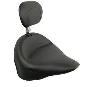

Hi everyone, does anyone knows where can i intstall an additional backrest on top of the exisiting backrest? For Gts 200. Something like the image attached. Backache after long ride. For the rider, not the pillion. Thanks!

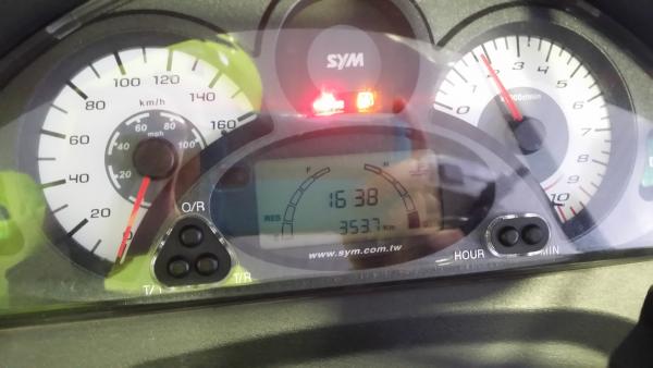

Hi bros, for those who get 350km and above (when hit reserve), what is your riding style?
So far I can only get 320km when hit reserve. My riding style
-50% highway at 80kmh
-50% city riding (start, stop, traffic light, etc)
-my weight 75kg, sometimes pillion additional 50kg.
-never rev above 6500rpm.
-when to to full tank is abt 10.5l
Is my FC consider ok?
uploadfromtaptalk1429434023234.jpg Sprocketty attach FYI ....
normally I reached about 400 km or so before the light switched on.
roughly about:
60% highway at 90-100 km/h.
40% urban riding.
weight is a secret:p but quite a bit heavier then you. once in awhile with pillion about 45-50 kg.
seldom rev above 6500 rpm as well.

To clarify, one bar left means reserve, no reserve (light on) means zero bar?
Btw 90kmh I'm getting any 6300rpm. 100kmh abt 7k. I find that it's quite sensitive to wind / slope.... I'm using dr pulley 16g roller. Shd I try heavier roller?
reserve is when the light is blinking with no bar left. I think that when you have about 1 more litres to go.
I am using 15 grams roller. 100 km/h about 6300 rpm or so. But lately the rpm seem to be going up. Not sure is it due to the roller wearing down or my air filter is getting dirty.
16 grams already quite heavy. You can try heavier but your pick up might end up very sluggish. Also, you might need stronger clutch shoes springs if not your clutch will be engaged even when engine at idle. What are you trying to achieve?
Edited by Isopropyl
I think my belt might be worn a little thinner... That's why heavy roller still 100kmh 7k...
Perhaps I go change belt!
I'm trying to get best fuel consumption.... My pick up at 16g roller is lesser, but ok for me...
try a lighter contrast spring?
