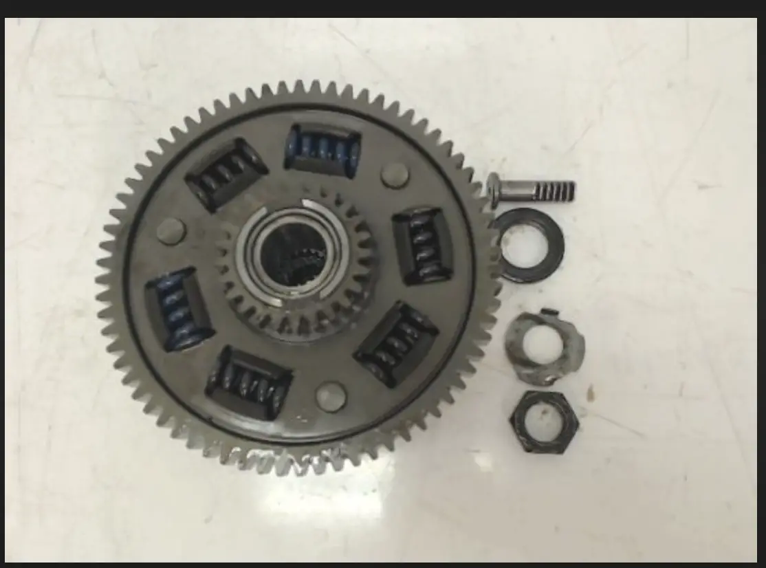

11 hours ago, apogeeXX said:
you changed the housing ?
as in the outer case ?
141645844_Screenshot2021-12-30at6_10_37AM.thumb.png.95869631dbf97744b9d98060ba1e4f17.pngI've changed the internal clutch housing as per picture.. LOL.. Definitely not the outer case..
7 hours ago, apogeeXX said:
For a moment I really thought u changed the housing 😅
Your bike is Yamaha mt03 ? The irritating sound is that metallic bristling sound ? So changing the plates makes the sound go away ?
For mine, it's MT03 and sort of.. originally it was super loud.. now it's softer.. :)
+ engine brake not so rough anymore.. (+ points)
overall alot smoother..

actually I change one more part before I tour to Malacca recently.. Clutch bearing.. it will cause your clutch not able to pull if you didn't change before.. that means.. cannot change gear.. 😂
No wonder no matter how much I adjust free play.. the bitting point is ALWAYS sooooo near... but now I change it.. it feels ALOT BETTER.. :)

On 4/7/2023 at 4:50 AM, Riana Rosli said:
Hi, i have the same issue that u had previously, how much does it cost to do all of that?
lube or change cable is cheap.. (<60?)
clutch bearing (I think I did it for $120 (+ 2 bottle of EO+1 bottle of engine ice)) cuz need to down one side of the engine and troublesome/alot of labour..
