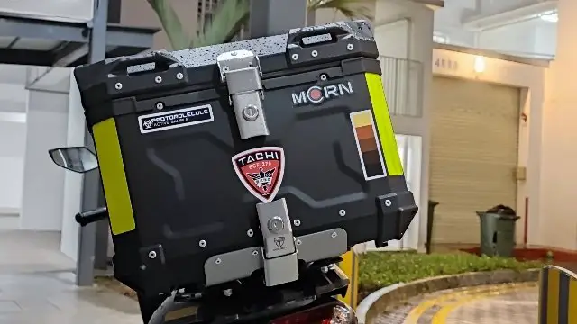

I believe I have a 45L version of this box, this kind of metal box seems to be quite common nowadays and I wanted a change from the boring old black plastic Givi boxes of the past decade.
My thoughts from riding with it since Nov 2021.
> The square metal box looks business-like, like what you'd expect a James Bond villian to transport funny things in. Put some faux warning labels and reflector tape for maximum effect!
> The locking mechanism is fun to play with, it feels military-grade from how chunky the mechanism locks and unlocks. Ditto for the baseplate lock, it feels very solid and not shaky like some old plastic boxes.
> My 45L box can neatly fit a 14 inch laptop bag, your intended 65L looks much wider and my giant Alienware gaming laptop could probably fit in it easily.
> Funny feature of these metal boxes, due to the excellent locking and rubber seal, it seems airtight. This is good and bad, good, if you put an aluminium foil insulated bag with ice pack, your ice packs can make a very cold space for a few hours.
Bad, if you park under the sun, very quickly the metal box heats up especially if your box doesn't have the fabric interior lining.
So if you deliver any cold or frozen food parcels, always bring those 'cooler bag' with the cold packs like Amazon.sg will send to you if you order chocolate or other cold products. For non temperature sensitive or warm items then of course the natural "heating" of the box under the hot sun is a bonus! Since the box is nearly airtight (assuming new condition) there won't be any internal cooling as you drive.
> Recommended to put an air freshener or small dehumidifier inside the box to keep it fresh, especially if you put damp items inside for a long period of time, such as bike covers after the rain. Else mold will start forming on any fabric. Did I mention it's airtight? Yep means moisture cannot escape at all. Need to air it once in a while.
> Driving at legal speeds, I don't think there's any penalty to air resistance since your body creates a 'wind shadow' in front of the box anyway. I did not notice any issue with fuel efficiency or aerodynamics since my box fits neatly within the width of a maxi-scooter rear end. The 65L and 80L mega boxes might stick out to the side a bit but bikes like X-Max or Burgmann are fat enough to accommodate the width without looking odd.

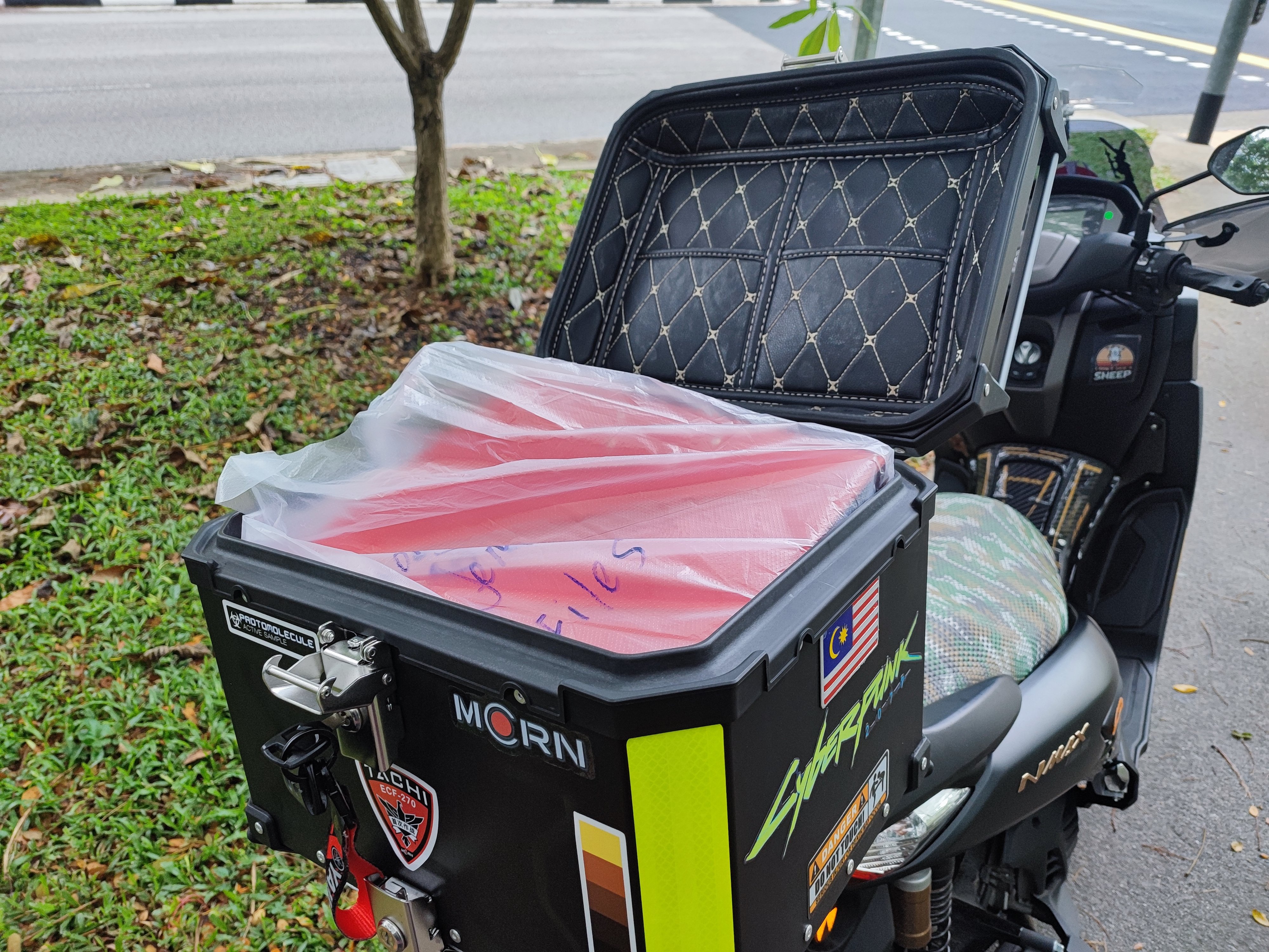

So happened I picked up a pile of files on an errand, and viola, square metal box fit square items perfectly. 45L can safely eat a stack of 5 or 6 of these school or office files just nice.
A round box would have wasted volume on the corners and not so easy to plan things like square 🗃 parcel capacity.
