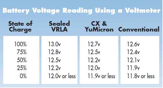

Multimeter indicates 12.56v when bike is off. Mine FBF16**. Urs? Edited by MonoWorld
This might be beneficial regarding the state of charge of the bettery
http://www.ktm950.info/how/assets/images/Battery-state-of-Charge.jpg

Hi Kevin, yea signs of discharge. Best u charge fully the battery at any workshop 1st and monitor it for a few days if the same thing happens again. If it does, battery is gone.
Anyway voltmeter is a good battery indicator but sometimes gives false reading and doesnt say how good ure battery is. It might be taking reading from the cell that is good while the rest have kaput, which I suspect happen to mine earlier! Voltmeter 12.2 but cant crank start. In the end have to push start. damn! Changing battery tomorrow ....:cry:
Yat, thanks for the info. I took out the battery to charge at home. I hope my charger is suitable because it goes to trickle-charging mode once it reaches certain charge/voltage level.
Wah push start.. just call me if you need battery charger. PP to Hougang not so far hehe.
Happened to me before. Basically if the voltage is low and it trickle charges soon or immediately after you connect it, you can say your last rites for the batt liao.
