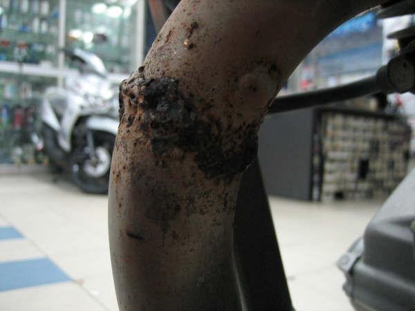

i tot rw header is chrome, how come your is so rusty??
a new original header here in sillypore cost about S$180.
u can ask daelim agent in my to assist shipment from sillypore
or call cka for mod stainless steel header.

guys, roughly how much would it cost to replace the roadwin' exhaust manifold? this one...
alermak... That manifold needs replacement.
Yup, $180 just for that part.
anbother 200+ for the muffler ONLY.
