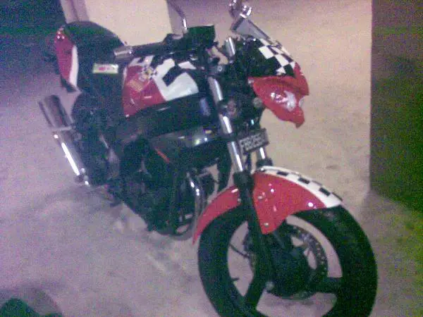

So quiet today, Juz rode back my newly attain RW from CKA, its a wonderful bike dat comes wif stare from other riders haha
Initially the riding posture is very very awkward to me but after sometime I sort of gettin used to it. Yes, it is slower than my old ride but hey the only thing in my mind is I DON'T MIND. I was expecting this but I just love it to every bits.

Toh guan one that u saw could be mine if u saw it before this Wed... :sian:
yours is yellow with checker italian style cafe racer??
why change? can be.....another hottest rw? :angel:
haha.. i prefer original colour bah.. hehehe...
but now looks so plain.. so going to detail the rims.. chrome the side...
so have more contrast... ahha
i think i saw it on tueday or wed afternoon... whent there for my 5k servicing...
u buang right side ah???

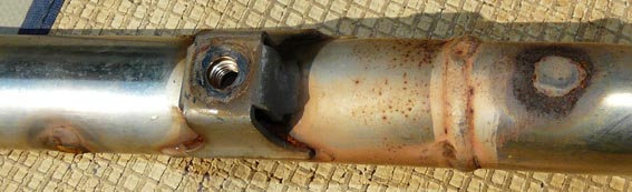

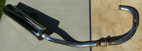

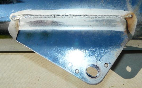

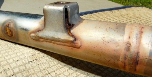

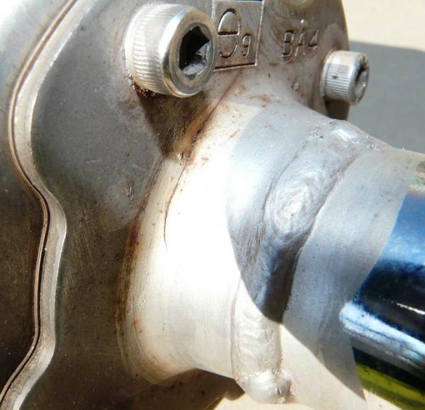

I was following the service manual to dismantle my muffler. Wanted to see if I could DIY an aftermarket muffler myself.
When I noticed that my whole exhaust pipe looksed a bit funny.
In the end I dismantled the whole thing, and noticed several "welded spots" along the whole pipe. And what looks like "bad welding" and perhaps even a crack at where the gasket meets the muffler.

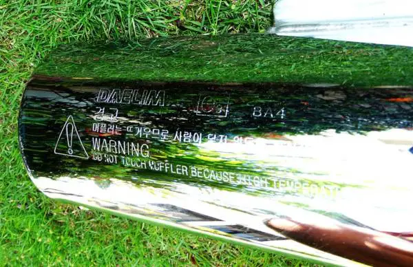

The muffler itself looks ok. Even got DAELIM engraving an all.
I don't have any other RW to check with, so I need some brudders' help to see if this is normal. I don't think so.
I think maybe kena buang before, and its a "patchwork" exhaust.
Here's some pics.
Hope anyone can comment and help out. TQ
yes, confirm crack line.
remove the muffler from the header, 4 allen bolts.
check inner sleeve of the header for further cracks.
u can send it to any welding shop n ask them to patch for u.
most weld shop charge $10 per job.
it's common due to heat n vibration, did my header too then change to SS header.
my previous superbike had cracks too, weld until cannot weld anymore.
buy a new oem set of header cost $1,000, aftermarket SS header cost $1,500.
rw SS header cost $180.
btw, i installed two header gaskets to try reduce vibration from engine.
header gasket is copper seal btwn engine n header.
the rest of pics looks norm, mid section might have done repair work.

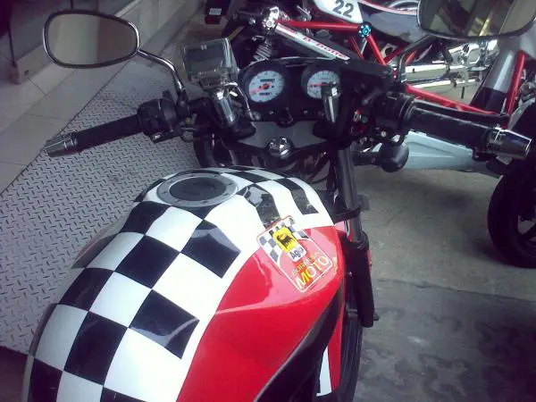

hey, what's that digital thing on ur bike's handlebar? :p
Yeah Stsoh, after warmin up of the bike (3-5 mins n trottlin 2-2.5 rpm of idlin speed for abt 2 mins or so) it really helps. But every start of the bike must do this or in the mornin when u ride?
i ever saw this bike at CKA kaki bukit....Is this yr bike bro???
:smile:
:popcorn:

Uncle Soh, what's "SS" and "Header"?
When I opened up the exhaust, I noticed 2 x "sleeves" which connects the front opening of th eengine to one end of the exhaust. Is that the "Header"?
I tried to unscrew the gasket and separate the muffler, but the @$^$ thing is so tight!
I think it may be welded together! How?
