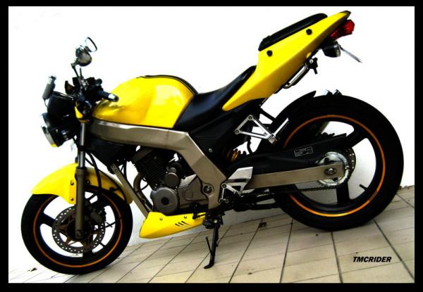

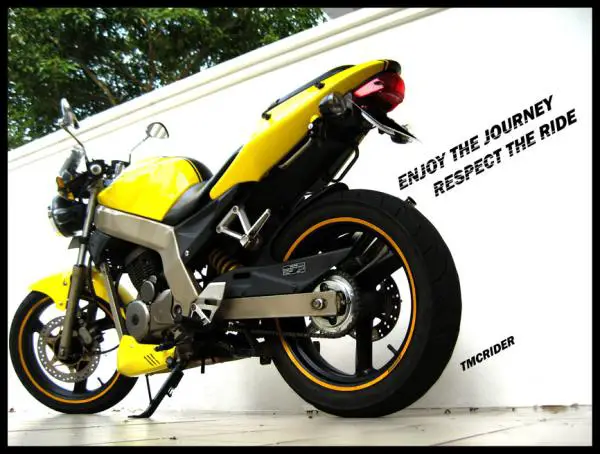

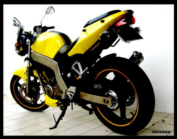

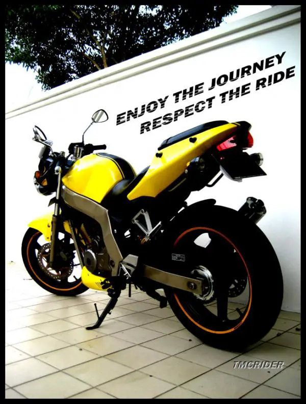

After scratches, sweat, blood and tears.....
Here's the current reincarnation of my pride & joy :D
Now all that's left is a mean exhaust.
Can anyone spell M-O-R-I-W-A-K-I ? haha
ENJOY!

omg nice ride.... :angel: :thumb:

dang!gotta love the yellow :cheeky: moriwaki? how much would it cost man? :cheeky:
