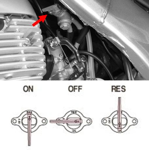

Hi im from Malaysia. It seems that Malaysia dont have many RW. So i found u guys abroad. Anyway. My questions to you big brothers out there, is do u know where is the Fuel C.O.C.K? the one that u can put reserve fuel in it! I went through the whole bike but dont know which is it. Im really new to the bike. Just got it last week! Thanks .. hope to hear from you all soon
wItH rOadwIn u cAn gO eVerYwHerE ! ! ! . . . . . :cheeky:
hey there..i'm from Malaysia too! yeah, roadwins are quite rare here..here's a picture of where u can find the fuel **** lever
Woo, if you're disciplined enough to check your fuel comsumption, then you're still ok. But if you're constantly forgetting your fuel count, then better to get that fuel reserve lever back so you can reach for it even during riding. :)
My personnel best habit is to constantly resetting the meter everytime i top up my fuel tank. At least I know I wouldn't wanna hit more than 330km for the tank just to play safe. :thumb:
i've been riding without noticing the fuel needle since i bought the bike:cheeky: was riding my friend's roadwin the other day halfway and we went outta gas and stopped by the roadside. turned the fuel reserve lever all the way down anti clockwise and woala! we had fuel to last us to the nearest petrol station. so i guess that thingy is really important:thumb:
Thanks "Suppose" will go check it out after work .. was wondering at that area for quite some time but never notice it at all .. with the picture.. i think i would be able to find it. Many thanks to u!!
you're welcome, and the credit goes mainly to stoh for he posted that picture a few threads back. ;) a very helpful guy who can answer most of ur roadwin questions :gun:
