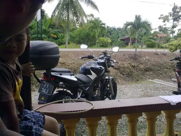

just come back from muar...
riding on the highway there is so shiok...
the rw feels more responsive when it gets stable with the speed and condition,
mantained speed of 100-110, and first time i get it over 120..
did not manage to change my stock sprocket set up before the trip as intend to drive up,
but car gave up on me as it need to be repaired b4 the trip...
overall experience, shiok feeling the wind of cool air from the morning mist..
lesson learnt, be more prepared for the trip, more safety gear, be as visible as possible..
cant wait for more riding up north...
Edited by lazykatak
