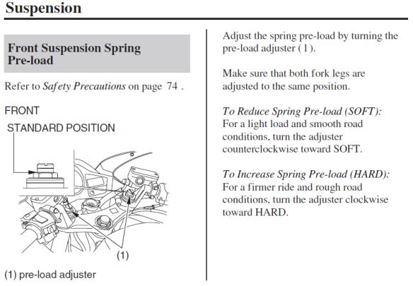

According to speck and other discussions - yes - VFR800 comes with front progressive springs setup
[ATTACH=CONFIG]293546[/ATTACH]
thank u jenga for ur sharing...but I guess the pic u shared was about preload settings
I've got the Hyperpro progressive...and I don't think they work better than the stock ones... :slapforehead:
if tats the case, I rather not have the hyperpro. It means the hyperpro is as gd as stock then..haha
totally correct - it was all I could get from the user manual about front suspension :-)
