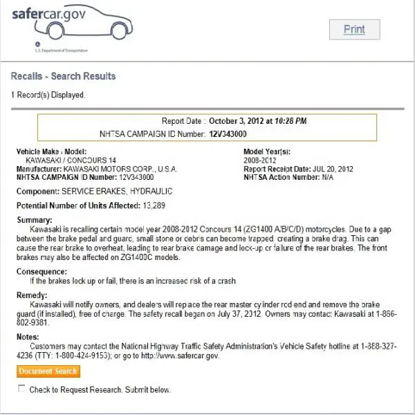

Hi Guys, Just to share. I guess it has been shared already but just sharing again. USA and Malaysia has annouced recall for 2008-2012 GTR 1400. Nothing from Evershine yet. I went to Kawasaki Motormatic Johor last week for servicing and the agent told me that Malaysia Kawasaki have started replacing the unsafe part. Please share with other GTR owners.
Cheers
Cheers

Dunno how many of e owners here having e same prob as mine : Sometimes when starting e bike, e rear brake light auto engaged.. Press e front lever, nothing happen but when press e rear lever, e brake light disengaged n back to normal..
"Shut Up n Ride"
I think it is cos your brake switch is stuck so even if u have depressed your brake pedal and released it after that, the brake switch is stuck in the ON position, causing the brake light to lit up.
Normally I will just spray some WD 40 on the brake pedal shaft cos the shaft might also be sticky and causes prevents the brake pedal from fully returning to it's position.
yahoo[/MENTION].com;7731462]I think it is cos your brake switch is stuck so even if u have depressed your brake pedal and released it after that, the brake switch is stuck in the ON position, causing the brake light to lit up.
Oh ok bro.. Tot it cud b e rear brake faulty thus e recall as mention by other bros here.. :) Thanx bro..

Anyone tried to email nEverShine and cc LTA a copy of the recall and see what is their response? Currently using ipad and cant attach any files.

I email the notice to onemotoring (can't find LTA email enquires) and ministry of transport. Lets see what is their reply. Called Nevershine ( no email too) and "Mr Ang" is not in till afternoon.

Called Evershine. They say our bike is from euro. Anyway to find out if the recall also affect the euro models? As they say they have NOT received any instruction from kawasaki Japan. FYI, Malaysia model is SE Asia model.

Was @ Evershine last Sat with a fellow pal (GTR Owner) and spoken to Mr Ang...
Claims by Mr Ang:
~ Our Model ... is Euro Model.
~ No Recall is know
~ If there is any... It's call FDM
~ FDM = Factory Direct Modification
~ Should there be any, leave the bike for 1 - 2 weeks for them to "CHECK"
~ Leave your Chassis Number and Contact number for them to check...

How come for a 5 mins job must leave the bike for a week? What's the difference between Euro and US model in terms of the faulty part? Are they going to wait till someone gets kill then they action? I recall back in 2010 I had the same recall and the installation of the part only took less than 10 mins.
