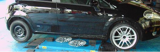

ok i actually wanted 40 or if possible, 45. but the shop which i bought the rims from didnt have stocks for 215/40/18. they only have 215/35/18. i ask abt 45 but they told me minimum for 40, width would be 225 and it cannot be fitted on the car.
which explains y the rims dun really look nice as it is now on closer observation. :D anyway, im waiting for this set of tyres to go botak den change to 215/40/18 hopefully it will make the gap look smaller.
http://www.singaporebikes.com/forums/attachment.php?attachmentid=35784&stc=1&d=1186111020
the rear's gap is exactly same as the front's gap. but due to the tyre profile. the front's gap seems larger. rear is on stock 15" and front is on 18"

Changing from 215/35 R18 to 215/40 R18, the difference of the tyre sidewall is an increase of 1cm so the height gained is 2cm. Visually, the gap (fender to tyre) is still big. The only way is to lower the car.
im trying to source for 215/45/18 if there are such tyres. im quite against lowering.

215/45/18 also a very rare combi if available.
For your car, actually 17" is max, in my opinion.
