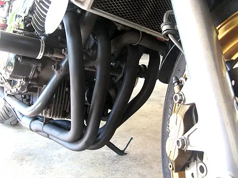

haha yeah i understand the feeling.. the look of the discoloured headers.. 2 hours? no primer? how many coats of spray you applied?
Yes, 2 hours to finish everything. There are two screws for each header (near the radiator mesh area), one screw at the bottom, and one screw at the end can to remove. Once you take out all the screws, the entire header can be removed. After that I sandpaper the header with rust remover, no primer. Applied two coats of spray, with 10 mins interval for drying.
As promised, here the pic
wow bro!! nice nice!! quite an even spread of the paint... looks lovely!! @@
Wow looks black and new.. Mine also rustly le.. always wanted to spray it back to black black.

Thanks! :p Whole body was drenched in sweat after dismantling the header, but after seeing the end result, it was worth it. Would encourage anyone not happy with the discoloured header to go give it a try. To get the even spread, spray at distance of 30 cm, and don't concentrate on one area for too long.
After a few days of riding since I sprayed the header, still looks as new, so I think it should last.
hmmm...wonder how long will it lasts..consider trying it too..

heard it doesnt last more than 10 months.. so maybe about 6-10 months lor..
U should use Amerol after spraying...
My headers i can say tat still black in colour even though got little bit of patches....
I use my bike for 1 yr + n the original coating of the headers still there....

i also jus did my header last week. did the lazy man way.. just wrap newspaper all ard n chia spray. 2 coat. 1.5 hrs. my high temp spray $7 onli..
Thanks for the tip! What's Amerol?
Wa...so cheap :p
Amerol is a white liquid use for black items...
Actually tat ting use for cars....
I try to use it everyday on the headers....
Looks the same original black colour till today...:thumb:
