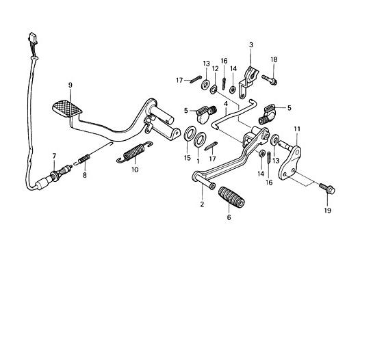

There is no external screw in the gear shifter lever to adjust the tension. There is however one inside the assembly (part 18)for adjustment, but again, it is limited by the "free play" worn out near the rod(part 4), and clamp(part 3). I had the same problem, so i went to buy one set while fabricating the forward controls by the way.
Like I said earlier, damn simple to change and replace. Make sure you have the following things and tools;
size 10 spanner (removing the bolt that secures the clamp to the gear pinion)
size 8 box spanner (for part 18)
pliers (to remove the cotter pins (part 17)
size 12, to remove the bolts (part 19)
By the way, the 4 piece you get is just (part 2, part 6, part 4 and part 3) no bolts and nuts and cotter pins whatsoever. So better have on hand some cotter pins to replace. The rubber covers (part 5) can be reused. And good to have a pail of water and detergent to standby, expect a lot of grime and dirt while replacing.

I bend down and checked the gear shift area, cant see much because it at night but it felt like a spongy stuff at the hinge. A servicing is due. Thank you for the wrench size. Do I need to remove the front sprocket cover? Mine is shift down gear sometimes not responsive especially from 2 to 1.

For the gear shifter, yes u do hv to remove the sprocket cover. I had issues getting 2nd gear. End up the clamping bolt was loose. Thats all. Do check on it.

had the gear shift part changed, $50.
Considering the fact that thebpart alone cost $38, the labour charge wasn't too high. Plus you save time running around.
