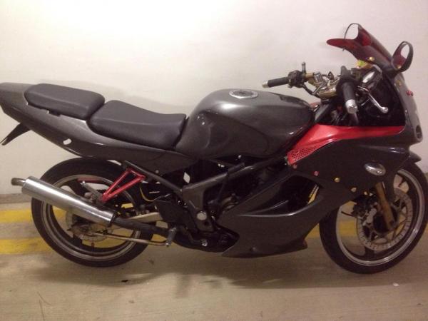

guys, need help. ive done DIY paintjob on my bike. last ting is lacquering.. i saw some said 2k lacquer is gd.. so how do i apply it? using brush or wad? help!!...
