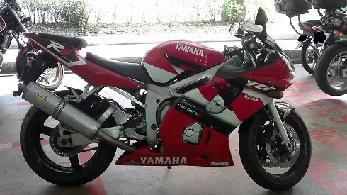

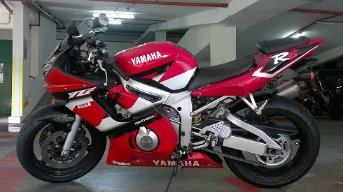

As promised, a couple of pics of my R6 after a wash :smile:
