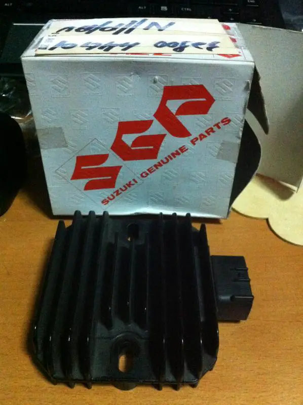

TO MY FREN WHOSE HAVING THE FLUCTUATING RPM READING:
Erm bro, i ever once encountered this and got my bike stalled in the middle of Mandai Rd at 2am.
haha but anyways perhaps wat is wrong is the RECTIFIER. coz it has a rubber backing, and the placement is near the engine compartment... it can be easily be melted. check it out. wat i did was to put an extention to my rectifier so it creates an air space in btwn the rectifier n engine. =)
hi bro care to elaborate more, pardon my noobness but what is a rectifier? and where exactly is it located on our monster?? thanks for the advise!!!

Rectifier,
It can be found on the right side of the bike. Beside the headers (The 4 pipes)

Rectifier,
[ATTACH=CONFIG]228219[/ATTACH]
Thanks Alex!! btw what is the general purpose of the rectifier? and how much would i need to fork out need be if i had to replace?

$176 from KS motors. Maybe higher if getting from Loois or Guan Hoe. Loois told me it'll exceed $200.
The regulator rectifier is a combined unit. It does the rectifying part as well the regulation part. It is part of a battery charging system. It gets a power feed, an AC power feed from the stator. Most of these regulator rectifiers and Stators are 3-Phase, for charging batteries, so there are three wires coming from the stator feeding into the regulator rectifier. Then the regulator rectifier “rectifies” it, and “regulates” the power to 14.5 volts and feeds a DC out to the battery. There are some single phase, regulator rectifiers as well that basically do the same thing. You have two wires coming from the stator, feeding into the regulator rectifier which is then connected up to the battery, so there is a DC output going to the battery.
My batt went dead suddenly this morning, do a push strt with the help of my fren, i ride to t.guan UM for a batt change.. but after changing of batt it seems dat my regulator was charging my bat very slowly n to a maximum of 13.8 volt.. shall i change my regulator? UM quote me the regulator for gsr is $245. Btw the $176 r u refering to the gsr regulator? Where is KS motors btw?
Yep, the regulator/rectifier. The black thingy.
Was your battery factory primed? Or did they prime it for you? This means they gotta put some bottles on top of the battery (The bottles contain Sulphuric acid which is needed for the battery to work) and wait for awhile before installing, if not, it should be factory primed. This could be a problem for older batteries which may not be as good as fresh ones.
Anyway, monitor your voltage. As long your voltage is holding at 13.5v to 14.5v. There's no need to worry. Give a few days.

Bro how much is the batt change? my battery seems to be constant at 13.8, sometimes go up abit 14, but when idling sometimes drop to 13.2 does it mean regulator spoil or my batt spoil?
How old is your battery? If it's pretty old and you gotta take some time to crank up your bike then it is time to change it. If the rectifier were to be gone case, the voltage will pretty much drop to around 11v - 12v
