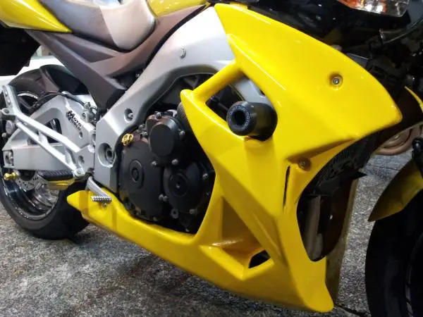

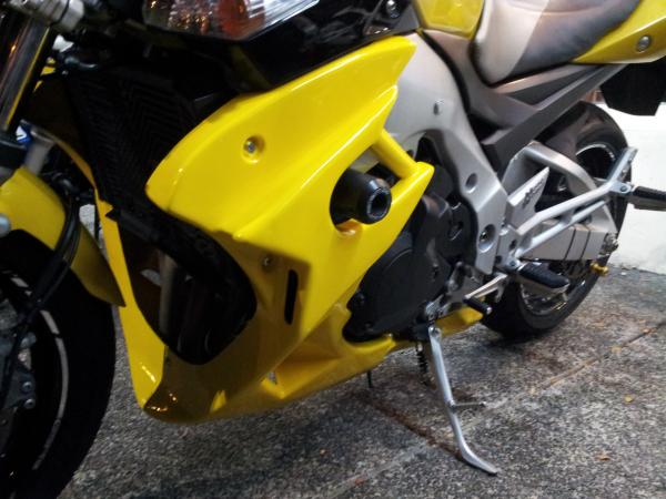

nice??????
We will be making another trip down to M'sia to Fix Lex's bike as his is awaiting for the paintwork...
if anyone wants to fabricate this... do join us on our next trip...

im interested to get the bodykits too. text me if you guys are going 91995758 ~ darren

This is nice!! Hw much n where in jb can i fabricate this?

Smintboy nice ah your bike wif the bodykits.. Go down msia n watch soccer again ah?? hahaha.. :angel:
