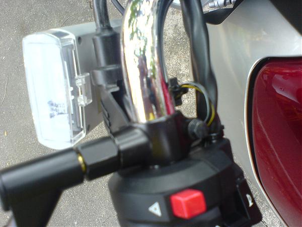

Hi guys, friend already collected his bike and his loving every sec of it. He had his H&B fixed and currently planning to get scott oiler and Tank bra.
But be4 all this, we noticed theres a wire on his left handle bar, and when we remove the socket, the bike can't start. Anyone disabled it or had it removed?
Below is the pic of the wire/socket im refering to. Please assist on whats that and should we remove it?
My concern is, in the past, K1/K2 gixxer has this fuse/relay black box thingy left above the ram air, which ppl can easily removed it and bike can't start. Wondering if its the same if someone cut the wire.

That looks like the switch at the clutch side. U'd have to clutch in to complete the circuit to start the bike.

You can try an cut...worst case scenario is bike cannot start hahahha.Anyway its a safety feature when starting the bike. So I suggest you leave it alone. Unless you know what you are doing.
Anyway its called "Clutch switch lead wires". Usage cannot discuss furhter here later crooks will know what it do. ahahhaha
By right you can just short the two wires together thus allowing the start of bike without clutching in. Only bad point is, if the bike is engaged at gear 1, while starting, it may 'move' the bike and causing a minor accident.
