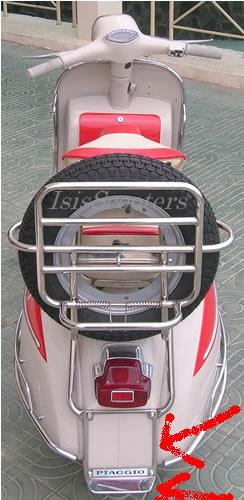

hey wanna ask u guys smth.. do u know where can the licence plate frame n the small bumper below the frame can be found locally? thanks..
the picture is taken from the website sharpey gave us earlier on..
