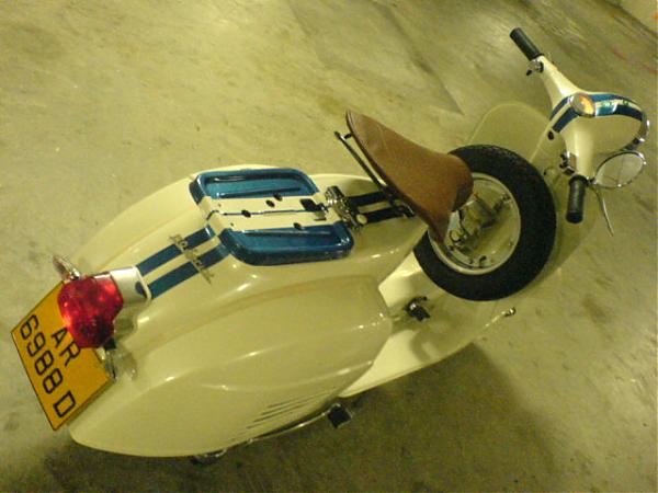

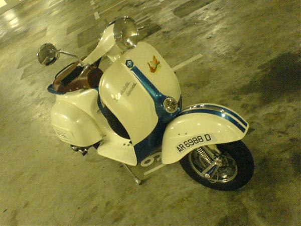

Awsome!!....how nice, yah, pop by and see what thy offer. haha, well sassy is all done and running now. just have to install the rubber panel and is all good. here a pic of him.
