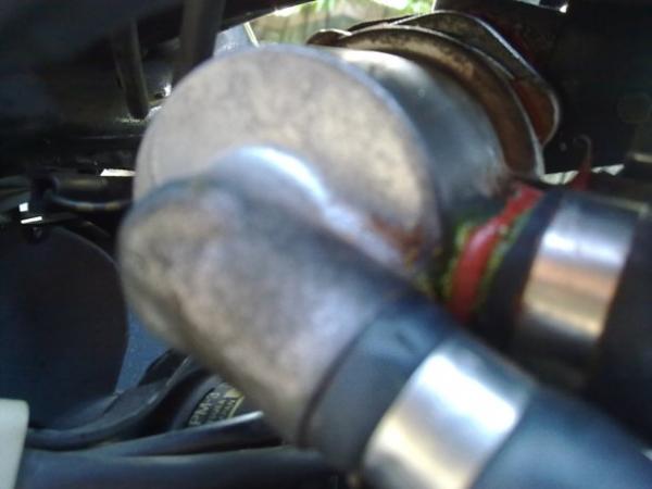

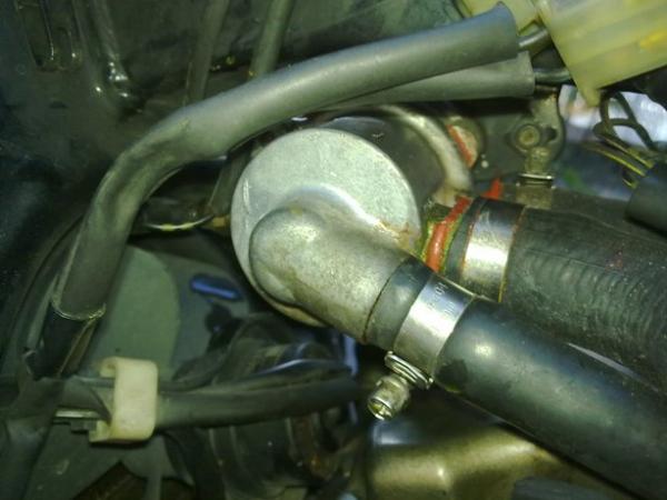

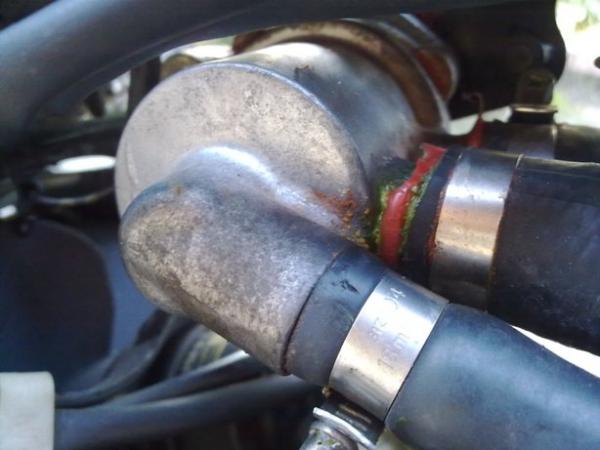

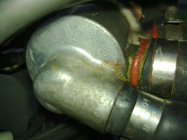

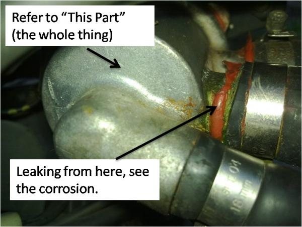

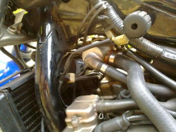

Hi All,
Appreciate it, if you guys can help. I understand that my coolent is leaking from this part of my S4 bike. However, not sure what is this part called (pls see attached photo). I may need to change the whole set of this part and not sure how much will it cost.
Hope someone in this forum can help to figure out what is that part called, so that it will be easier if, I want to buy from FJT or Ahboy..
Thanks guys.
Hi All,
Thanks guys.
[ATTACH]112605[/ATTACH]
[ATTACH]112606[/ATTACH]
[ATTACH]112607[/ATTACH]
[ATTACH]112608[/ATTACH]
[ATTACH]112609[/ATTACH]
That is the outer housing that houses your coolant system thermostat inside..this is Vtec version and different from that of non Vtec. You said "this part"..just not clear enough to justify your actual leakage problem. It could be the hose cracked, the thermostat housing or the hose locking clips cme loose or has cut the hose (leaks under hot coolant pressure). Normally thermostat need to be change only if they can't open for coolant flow and when heat pressure builds up inside, it tend to push out through the hoses joints which is hold by the circlips.

Hi Ah Pek,
Thanks for the useful information. Sorry that I was not clear of the situation and too many photos that may confuse. I have inserted another photo(refer below) and also inserted some illustration.
My mech says that the leaking is due to wear and tear of the "outer housing" and also due to corrosion (bike is Vtec 2, FV plate coming to 6 yrs).
So was wondering what is the actual name of "this part" and possible to get it from FJT or LAB? Can also advise, estimate how much will "this part" cost?
Thanks n cheers!!

Cost I would not know but telling them its a Vtec2 Thermostat housing should suffice. Can just call them and get quote. I believe LAB oso got lobang to get it cheaper..original of course.
You may want to let the mototiam do it..afterall, your fuel running up and down oso does not save you much. Most bike shop when they buy parts, they have a 15% to 25% discount from these spare part shops..plus there label and errand fee..its very normal. Troubling yourself is pretty much cumbersome this way unless you wanna DIY for the fun and joy of it.
