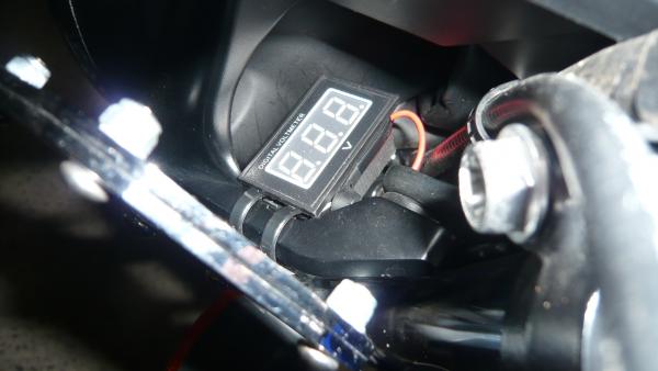

Hey guys just got my revo today. Still getting used to the bike. Hehe, oh and I would like to ask, what's the normal voltage when riding?
14.4V is optimum, my bike runs at 13.9-14.0V. This would be closer to 14.4V if the headlight was able to be turned off. I added one of those cheap Chinese voltmeters off AliExpress ty-rapped to the lefthand instrument bracket. It is accurate to within 0.1V - very good!

Because while riding mine is at only 13.3, what could be the issue?
Are you sure your voltmeter is accurate? Where are the measurements being taken from, further away from the battery = less volts. Try charging the battery for a few hours.
