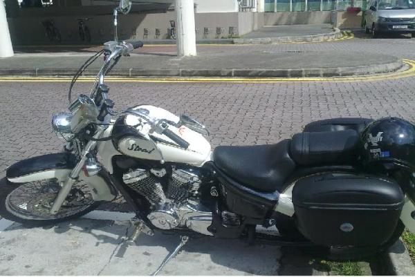

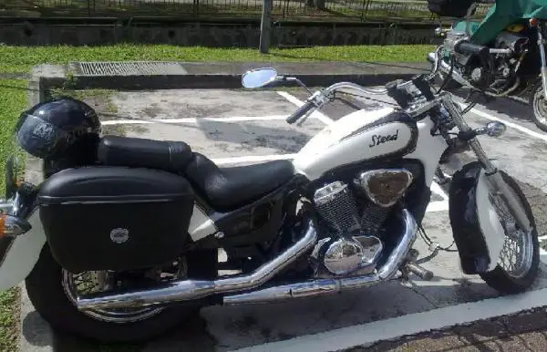

Just got my steed this week and would like to share with you. I got from a bike shop, they have done all the necessary work, so far so good. if everything good, i will post the bike shop name later for your ref.
Enjoy with the pics

looks like shadow fenders... easy to spot u otr if ever meet i guess. :)
