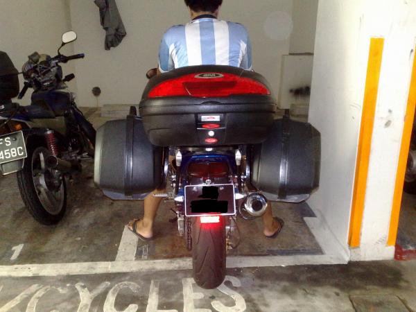

oh ya this is picture of my bike with the sidebox. but normally never use sidebox. sidebox is in preparation to go touring but not fully prepared to go touring yet. bike not 100% ready :)
:slapforehead:
alamak, i matapotek..
nw then i see yr post.
frm yr pic, yr right box seems tiliting dwn.
ok, suggest you go add another bar from 1 side to another, bypassing the rear mudguard.
adding on, get the base plates change to metal de(ignore if oready is), go SK & ask them to add reinforcements, maybe lower yr exhaust so can lower the boxes too, comfort for pillion.
But be prepared for the quote & leaving the bike there for minimum 1 day.
for more sturdy setup, get a strap with clip, thick enuff to secure the 2 handles of yr sidebox, & strap them together when OTR touring.
