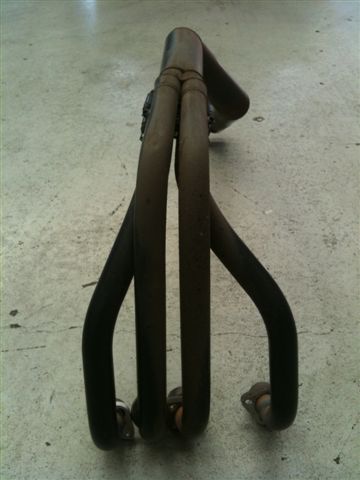

I've been wanting to clean up the dirt/browning/scratches etc on my black shorty for a while so as previous posts bought 2 of these paint spray cans to restore the exhaust back to it's original colour & condition.
This is the exhaust before:
http://i925.photobucket.com/albums/ad93/ResmeN/Moriwaki%20One-Piece%20Black/IMG_0285.jpg
http://i925.photobucket.com/albums/ad93/ResmeN/Moriwaki%20One-Piece%20Black/IMG_0286.jpg
This is the exhaust after:
http://i925.photobucket.com/albums/ad93/ResmeN/Moriwaki%20One-Piece%20Black/IMG_0302.jpg
http://i925.photobucket.com/albums/ad93/ResmeN/Moriwaki%20One-Piece%20Black/IMG_0301.jpg
[ATTACH=CONFIG]206726[/ATTACH]
Sprayed the whole pipe from end to end bro. Took it apart and sprayed the joints as well. Sprayed extra coats around the header and end areas as they seemed to brown the most.
Never realised just how dirty the underside of it actually was. From looking at above pic it looks yucky.
