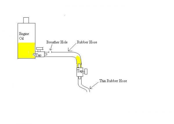

gatsby wet and hard gel... uncle mepkoh you are more extreme than me :cheeky:
thus, you have to find the highest point of your hose :smile:
refer to suggestion..the hole should be:
1. some distance away from the pump..lets say min 5 cm.
2. make it on the vertical part of the tube..
under equilibrium condition..the hole should be above this oil level..
so when u pump..the oil will flow ..on the way down the vertical part..it will go down rather than out of the tube...of course the hole is small..u cant even see it once the pick is withdrawn...try and eror will determine the size of this hole which directly correspond to the depth that the pick is push in..
cries... My ang Mo fail.. i still don't really get it/understand ;-( any diagram to help this Poor understanding dude?
I already posted drawings to install air holes in a previous post some pages back, but the drawings were pretty small because they were not scaled for the thumbnails.
Here is the expanded version of one of the same drawings.
The breather hole on the tube is to enable for air to flow in or release out of the tube?
from my understand , the hole is to enable air to flow in... you can try it on your shampoo bottle to understand..
both..this is air pressure equilibrium technique...
when you pump..the air is forced out....once the oil flow past the hole air gets sucked in.
Thank you for ypur clarification
