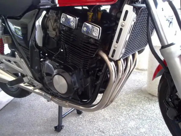

Went in last night to AGL to paste the rim sticker on my Impulse, not exactly the one which I am looking for but anyway I am happy with the result. The seat wrapping they could not do what I asked for so I did not proceed.
Washed my bike for RM9, they did a good job to remove most of the grime on my bike, it looks much cleaner now. I did not wax, because my paintwork not so nice, anyway it cost another RM6 to do so.
I am pissed with myself, wasted RM100 on the sticker job on my impulse, which the sticker shop boss promote to me an customize RXZ retro design. I feel it look f***ing ugly after its done, immediately I tear them off at the pump station. Could have spend the $$ on engine oil change instead.
Should try sport bike's type of stickers next time.
Maybe will join u next time to see see look look at AGL.

I noticed my impulse is leaking the EO a bit. A few drips noticed after each parking of few hours. No thorough tracing on it yet but seems to be from the nut around gear pedal. Is that normal?
I did not seal the fuel hose to the petcock, I took out the whole petcock, disassemble to clean and seal the gasket on the petcock as the source of the leak is at the petcock. It seems your petcock is leaking like mine, try to clean off the oil and observe if it still oily and wet then confirm leaking, you can purchase the sealant(Three Bond high temp grey sealant, $5) from KS, its quite good actally, as its resilient to petrol and seal very well. Also I use it to seal my old thermostat gasket and engine cam cover gasket after service and no leak at all.
The float assembly is inside your carb, you can ask Guan Hoe to check for you. When I check mine its sagging and does not spring up as fast when I push down compare to the new ones which I bought a few years back previously for my ex ride (it cost $45 ea per float assembly inclusive of the needle valve). The picture of the old float assembly as follow
http://i184.photobucket.com/albums/x97/S750WP/SNC00185.jpg
I have tried to experiment with various setting, result as follow
1.5turn out its too lean, bike cannot idle properly, and the exhaust fume has a burning smell(lean), rev meter is sticky (rev needle come down very slowly to idling speed) when rev at idle.
3.5 (original setting) turns out, exhaust fume can smell incombustible petrol (rich), rev meter needle dip below ilding speed when rev at idle.
2.5 turns out, work nicely for my bike, bike idle smoothly, the rev meter needle is responsive, the needle rise and dip to the idling speed instantaneously. And the exhaust fume smells just right :angel:
I think its not normal to leak engine oil, are you using chain oiler? Because I observe a few drips of oil stain under my bike when park overnight too, but its due to the oil from my chain oiler lubricating the chain. And there is none if I stop lubrication my chain for a week.
