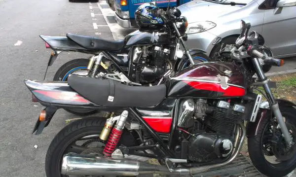

thks bros.
not my bike.
i was thinking to buy from the one from the ads in this forum.
he trying to start for me to hear the engine.
crank a few times.
honest gentleman and tell me outlook back.
but engine really good
Sent from my MB865 using Tapatalk 2

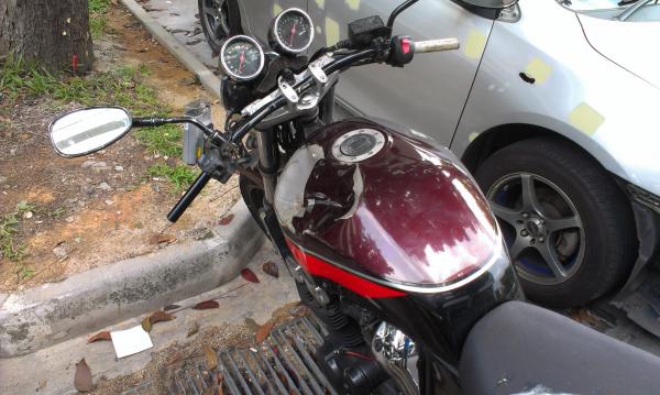

1 good engine but very bad exterior. tank detended.
the other good ext
engine sound quite loud. compare to the other one.

what color is the bike with the tank dented? its very hard to get replacement tank unless you want to ship from Japan. will cost you around 200 SGD at least.
can specify what engine sound is loud? tapping? or the combustion?
