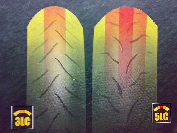

Has anyone tried BT016 Hypersport?
What r e fed back?
i intend to get it for track use, do u guys think issit suitable??
went to check at Youtube for BT016, those racer used it like a slick tire, can corner til low.
i jz wanna know issit a soft n sticky compound tire.
Thanks
If i'm not wrong, the front tyre has medium in the centre, soft at te sides.
Whereas the rear tyre, hard centre, then medium till soft towards the sides.
Thought of trying them, but i think they cost above $500.
Btw, when u watch racers do it, like MotoGP for an example? their tyre profiles are different from ours. Example, we're using 180/55 or 190/55 for the rear. I think theirs are 200/60 or even bigger.
http://sphotos-f.ak.fbcdn.net/hphotos-ak-ash3/625498_10151506336500777_489049580_n.jpg

These tires seem very suitable for PG..I noticed the most wear on the tires after practice at PG is in between the center and sides..
So a medium compound in between that area can last the tires longer at PG maybe??
