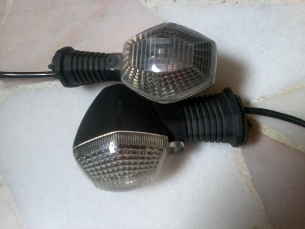

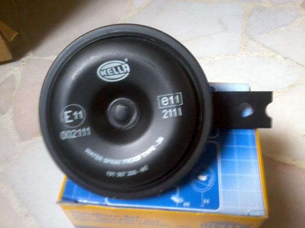

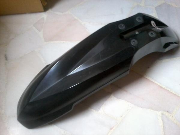

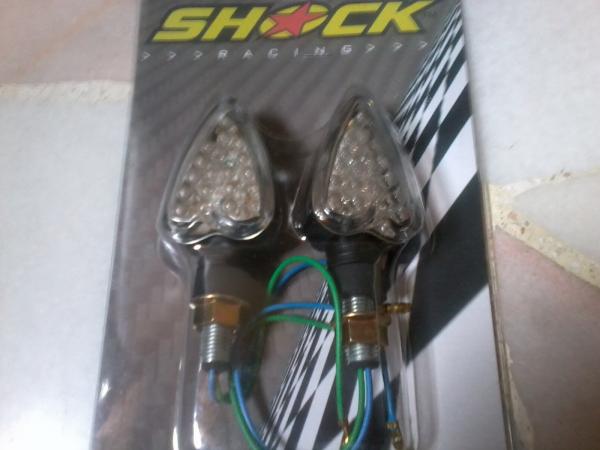

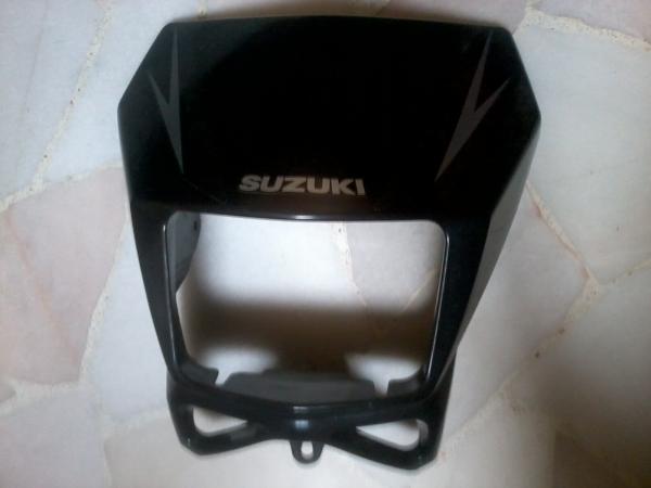

Guys! Help me clear some of my drz stuffs! It's going for cheap! Thanks!
Drz Headlight(RESERVED) - $20
Super Motard Front Fender - $30
Original Drz Signal Lights - $10
Brand New Hella Disc Type Horn(High only) - $20
Brand New LED Signal Lights(Never open before) - $20
Call or text me if you guys are interested, Farhan - 93358460
