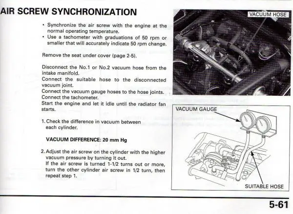

any other bros can double confirm that? :clap:
if its really so, seems my guess wasn't too far off.
my guess was they're either some mechanical "knobs" to alter either fuel-air or ignition timing of the SWing's EFI engine, other than depending on the ECU.
i tink this should be able to confirm ba ...

How come they connect to the vacuum ports nearer to the front of the bike and not the 2 at the back next to the idling screw?
Hmm... my mech says to use the ones at the rear cos thats where the intake is.
Anyone got other comments or just that both sets of ports serve the same purpose?
u trust ur mech or trust manual from Honda ? o_O
Wah.
Where to get a copy of the manual?
Not many bike shops (even BS?) would know the finer details of silverwing to do a good job.

Wah.
ebay is the place......

you're the man spin37 :thumb:
btw, you have the manual? :angel:
can i put your attachment at the SW Tech thread?
pls go ahead bro.. :)
