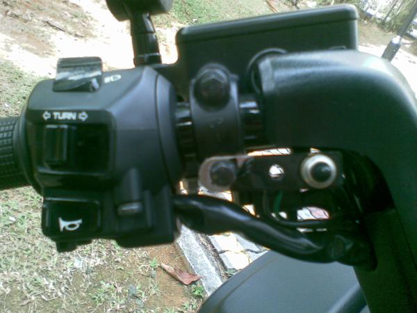

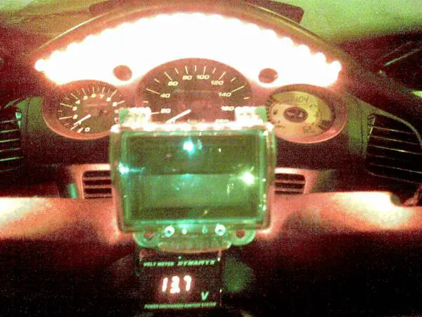

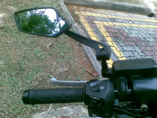

hi guys! some pics of my hazard light switch, voltmeter placement and koso mirrors... cheers!
ur voltmeter very easy get stolen lei..last time i place same location as urs. It was there less then 1 mth, then gone with the wind liao. not to pour cold water at u but I suggest u shift it.
There's lots of red eyed pple out there waiting for new gadgets to be available for them. Mine was gone at Plaza Sing. carpark :dot:
