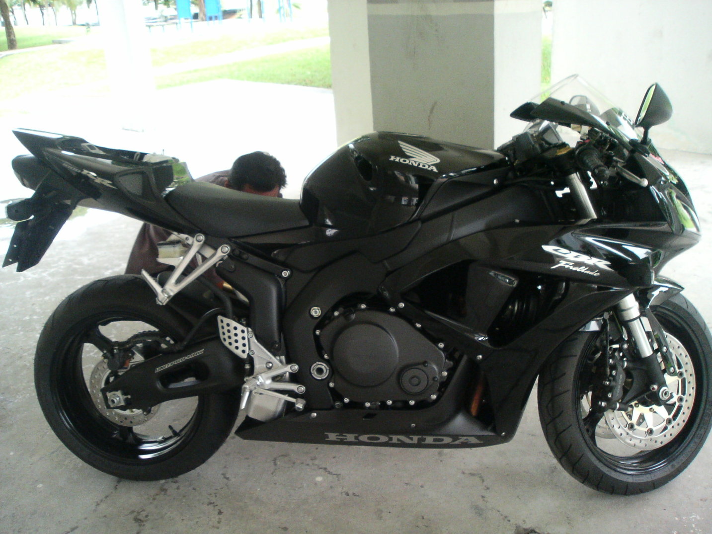

Hello evryone..My fiance and i just got our CBR1000 2006 model today from Mah pte..Plate FBB1920*..Juz wondering about the tyres..The stock ones..Are they slippery when its raining? If we want to change tyres..Any recommendations?? Thanks soo much..
:cheer:
Welcome to SBF. You posted in the wrong thread. This BabyBlade thread is dedicated to CBR400RR riders. There is a thread dedicated to CBR919/929/954/1000RR riders. Please post your questions there because the people there are much more knowledgable about your 1000RR than us.
From experience, most supersport tyres need to be warmed up a little. That may explain why the tyres are slippery when cold in the rain. But I think most new sports bikes come with adequate tyres.
You might actually want to set your suspensions. You will be surprised how much properly adjusted suspension can improve the bike's handling and traction.
Oooppsss...Im so sorry guys..!!
Anyways thanks for the info yah..!! :cheer:
