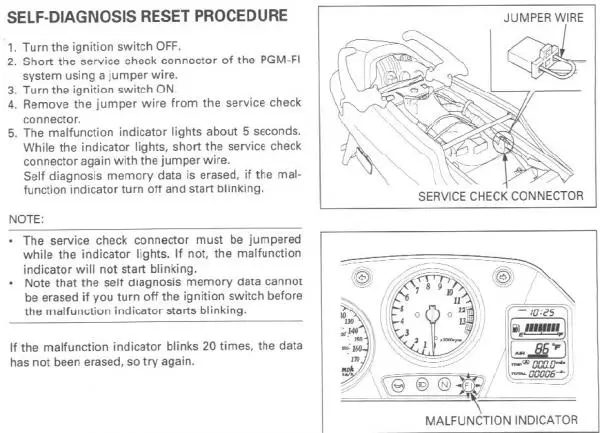

i hav the FI problems b4 oso... but ever since i reset the ECU i have nvr encounter FI light up anymore.. dunno why
http://forum.geizhals.at/files/2455/Vfr_logo.jpg
Reset ECU? How is it done?:confused:
