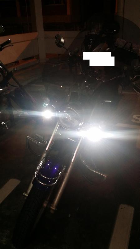

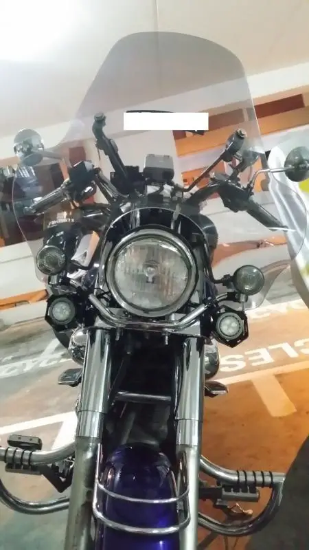

Hey guys, I am gonna diy some spotlights. Problem is, I don't know where the ignition wires are. Can anyone help me out? I need to connect a set (+ve and -ve) to the battery and also the ignition. Thanks!
I just complete a project for fog lights...
You can use the circuit diagram posted in the DIY thread. The power should be tapped from the battery and relayed using a Borsh Relay. LAB sells it for $8 per piece. The ignition power switch can be either spliced from the brown wire from the main accessory socket, or you can connect it to the high beam (blue) wire in the headlight socket.
Edited by matthias76
Hi matthias67...nice fog light set up... I would have fixed blue n red light instead to scar off all the cars...hehe.
Btw, where did u get that crashbar from?
Aunty Shop Ubi. $120 or $100...can't remember the price liao.
[ATTACH=CONFIG]315772[/ATTACH][ATTACH=CONFIG]315773[/ATTACH]
Thanks for your help!
