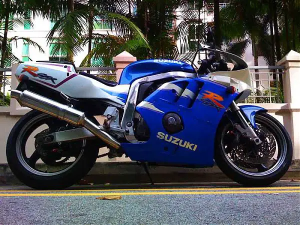

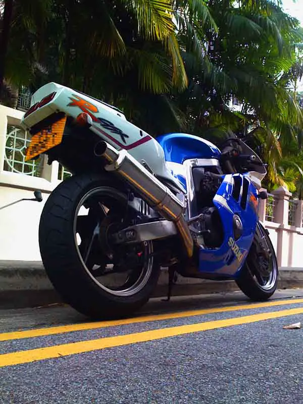

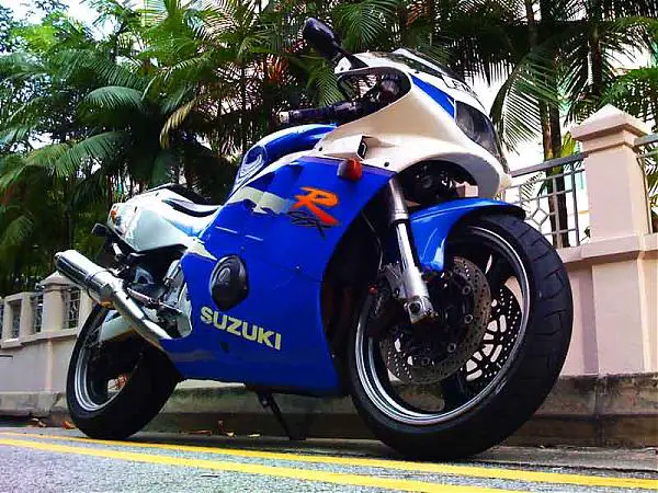

Here's my 3-week old ride!

nice paintwork...original paintwork or resprayed before?..anyway who did u get ur bike from? don't tell me its rodney...and i'm also looking for a yoshi pipe...not easy to find a good condition one..unless u're really damn rich..then go get a class 2a yoshi pipe then go down to seng kwang to modify it to fit our bike..haha

It's original paintwork, never been resprayed.
And i don't remember the seller's name being rodney.
alright..just checking..coz the paintwork looks like his =) enjoy ur ride on a G4 :thumb:
