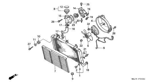

[ATTACH=CONFIG]299477[/ATTACH]
Hi simon , are you referring to item number 13 ? Thanks
yes. Exactly.
After you install it, it should be fine.

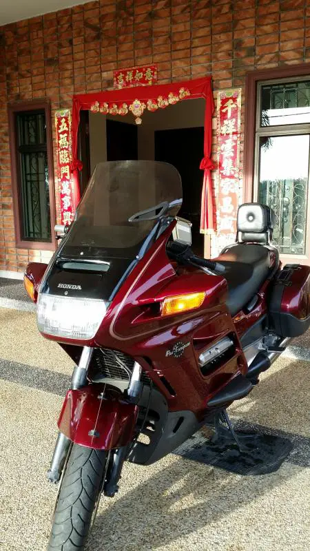

HI, i'm looking at getting a st1100. like to check is there 2 different version of st1100 ? pan euro and non pan euro, if yes please advise whats the different and how to differentiate other then via the logo? TIA
E.M, The US version will have the speedo in miles/hr. The pan euro will be in Km/hr.
Thanks. So that's the only difference ? Or is there such things as pan euro version is better etc?
Asking as I intend to get a st1100.
Try to look for "pan euro" because they have the "upgraded" 40amp alternator, US models pre'96 tend to have the older 28amp alt(looks different from 40amp alt), giving it more reliability issues from electrical point of view. US 28amp model also have separate rectifier while pan euro has inbuilt rectifier in the alt assembly.
Engine wise not much different except I saw some US model have holes under the block for pair system, pan euro has those blocked from factory. If you're interested in ST, look for the last few batches(~'00-'02)
I saw a "pan euro" with miles/kph together speedo on sale few years back, think owner replaced it with US model meter as mileage is very very low & the color code is pan euro model.
If original pan euro paintwork(except TP model), only 2 colours available, metallic blue or maroon.
Hope this helps.
Hope this helps.
Thanks bro. So all pan euro version will have the wording pan euro on the fairing? Is there any rides that are pan euro version but without the pan euro stated at the fairing?
I do not trust the badging alone.
US model tend to have ST1100 wording on the fairing under the mirror while pan euro is a plastic badge.
If it's original "pan euro" version, it should have that badge unless bike was resprayed & didn't put it back.
You'll have to look for the model + colour code located underneath the seat, mine was ST1100Y model.
Bought a brand new pan euro Y model back in "00, use for 10yrs, stolen in bolehland so got another Y model again.
You can google for more info between the difference and more details.
