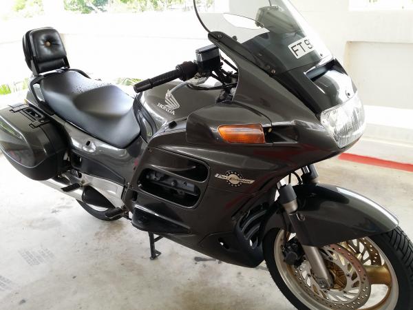

It is with great pain that I have to do this. Selling my beloved 2001 ST1100Y. COE till Sep 2021.
Accessories include: Goldwing switch, RAM handle mount (for phone, gps), rear seat backrest. New front tyre. New front brake pads.
Mileage 179K. Went touring to Genting only once.
This is my 2nd ST. Reason for selling: Just got another bike. Asking $7800.
Interested please Whatsapp at 9068 0058. (note: I seldom login here)
Thanks guys! :)
